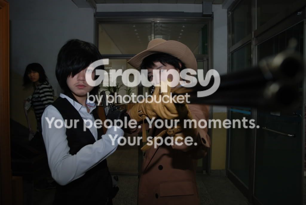

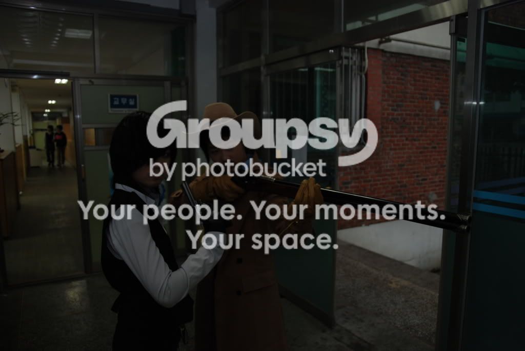

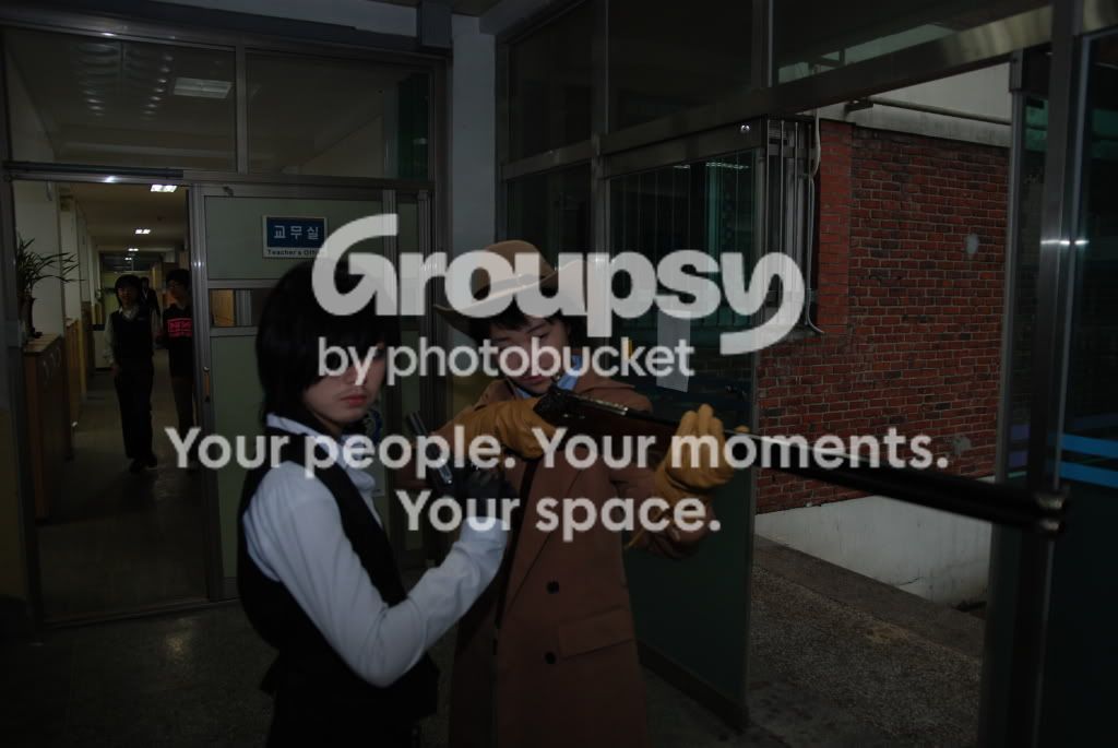

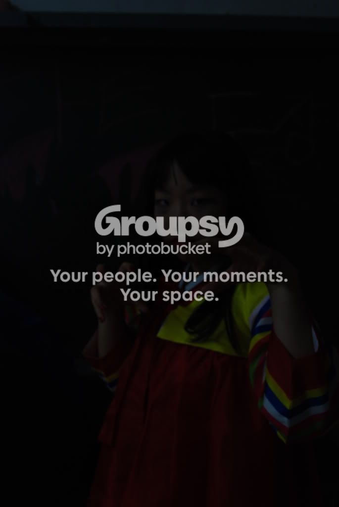

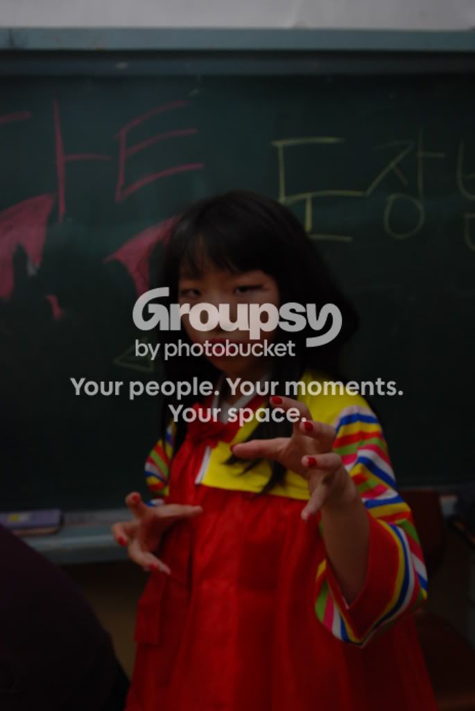

I've finally been able to keep my pics uploaded. The pics I uploaded turned out pretty good, but most of the pics I tried to bounce the flash on look like the dark ones here with no change. I need to be able to get consistency and to be able to bounce off walls (which none of the photos I tried to bounce off the walls turned out good!).
Please give me criticism on these pics on how to make the lighting better. As stated earlier I have an SB600 with a Nikon D80. Outisde was very cloudy/rainy so each of these pics are indoors with articifical lights (fluorescent); plus some of the lights were covered with different colored papers (it was school festival day). In the pics I bounced the light off the ceiling, and was just lucky it worked. I have no bounce card; I just aimed the flash up.
First pic is no bounce, or a bad bounce.
Second pic is with a good bounce.
Third pic is with a bad bounce.
Fourth pic is good bounce.
Fifth pic is with a good bounce and it is just fun.

What were you bouncing these off of?
The ceiling in that particular area looks a bit high... that may have something to do with part of this, but I wouldn't think it would be high enough to have this kind of effect.
It looks like your flash is in some "optional/M" mode... which looks like you don't have it setup right. You should be in Auto/TTL mode (at least for now until you get used to the flash and how it works)
er...in most of those it doesn't even appear that your pop up flash fired.
Your pop up flash HAS TO fire with the SB600 because it works as the commander flash. It tells the SB600 to fire.
I THINK...someone with Nikon flash and flash knowledge, period, please correct me if I'm wrong.
There's been times where I've forgotten to pop open on my pop up flash or there's been times where I've forgotten to turn on my SB600.
I SOON realize my forgetfulness/stupidity/whatever-you-want-to-call-it, and I fix it. What are your regular camera settings for these?
If you have a flash in your hotshoe, then your popup flash should not be firing.
i see that some of the pics with a bounced flash are still a bit blurry. heres my advice to you:
1. maybe try setting the camera to rear curtain sync. from the factory nikons are set for front curtain sync. in front curtain sync, the flash fires on the opening side of the shutter. in rear curtain, the flash fires on the closing side of the shutter.
2. hit 'mode' on the flash until the lcd screen reads *2 lightening bolts*, ttl, bl on the upper left hand side of the screen. this is basically 'auto' mode and the poster above who said sometimes manual flash can be confusing is right.
3. also, it might be that your shutter and aperture are affecting the picture. try setting the camera on 'program' or 'auto' and see if that helps
