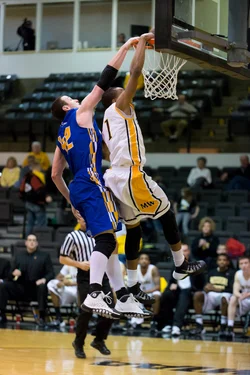

I have been shooting sports for my college recently and really enjoy it! The lighting in the gym is terrible! I shot the entire game at ISO 6000 F2.8 @ 1/800ths. Basketball isnt really my favorite sport to shoot just because of the lighting. CC please ! I love getting better, so tear them apart.

On the first one, you've got a lot of potential drama in #3's face, which would suggest that a tight crop might be in order. However, his arm blocking out the defender's face detracts from the image. If you shot this as a sequence in burst mode, maybe one a little bit before this would have been better.

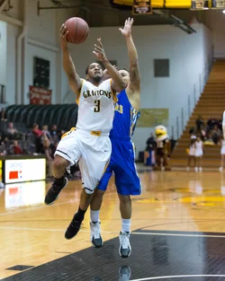

Number two, the two main players seem a little disjointed to me - like they don't really have a strong connection with each other. The other players in the background also add to the clutter. In fact, the way things are sitting right now, it looks like you're using the shooter and defender to frame #15 - like he's the subject.
Again, I think I'd like to see something zoomed in a little bit more, and something more 'frontal'.

I agree with tighter crops on 1 & 2, especially the look on the shooter's face in #1.

Thanks guys! Appreciate it !
Tighter crop will make the first two much stronger images. The action is there. I wouldn't have kept the third one, not having the faces is pretty much always an image killer in sports.
