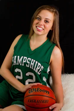

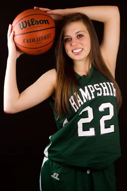

Indoor lighting what can I say I have a difficult time setting things up especially in such a small space. I used my canon off camera flash with white umbrella to the left of her and set my other umbrella up to the right of her. I dont have a meter and some what used the meter on my 7d. But with flash I get alittle confused on how I should compensate for the meter reading while using flash I used my nifty 50 at 3.2 1/100 sec. What do you think? I am going to purchase a soft box real soon .

I think you did alright, though I struggle with OCF myself. I'd say the first is better than the second in terms of light. Her right arm is a bit bright in the second, but again it's not bad!
The composition could use work. They are both cropped very tightly and the pose in the second just seems awkward. I don't know which is the subject and it confuses my eyes.

Ty jowensphoto for your input . Im not a fan of the second pose either but she asked if she could pose that way and well I said sure . Yes I'm from Wv about an hour and half away from Winchester.
Yes, not too bad at all. Nothing that a little more experience and refinement won't make better. Watch the hot spots. Go for a big softbox. The unlevel bg in #1 is visually distracting.
I'm not crazy about the seat covering in #1, and I believe this shot could use a bit more light on the left side of her hair. (right side of model)
You've cropped her elbow.
I like the pose and frame of #2. Her arms echo the sides of the frame. Good balance, good light on her face, but as mentioned above, too much on her arm, and perhaps not enough on her lower torso. Also, the ball is casting a shadow on her hair. I think this shot could benefit from repositioning the light to more straight-on.
Also the crop is quite close so if she is going to frame these, make sure there is a little more margin all around.
IMO your shot is good and i don't see a problem with your white umbrella, but if you setup your umbrella like 2 foot from your subject then i would say move it back to 3-4 foot and add one stop to your flash. This may slightly light your background though. And like stated above maybe bring the light angle slightly back towards the camera
I like #2 best but only cause im not a fan of her angle. Looks like she may fall over. Nice job though, Im more impressed that your working with what you have and making it work.

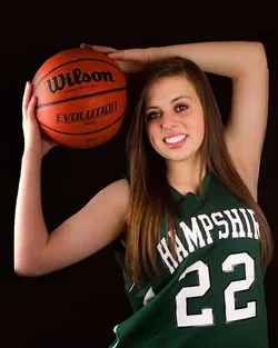

Cloning in some extra canvas area around her, as Lew did in Post #6, really improves the second photo. I see quite a significant difference in the uniform color between shot 1 and shot 2...was that intentional? Not that either uniform color is "bad"...it just seems odd that there is such a big difference.
I do not think the white rug is really a good posing aid for women's basketball shots...just does not seem to be situationally appropriate...
I think the pose of #2 is more "fun" than the static-feeling seated pose of shot #1.

I know its cropped to close and to be honest I was as far back as I could go and with the prime I didnt have much play if you know what I mean. I do have a 18-200 telephoto lense but it isnt as sharp as the nifty 50 . I would love to have the 24-70 but at this time I cant afford it so im trying to make what I have work. I love the added space around her but I want more of her body in the shot . How did you do that? the umbrella light was about 10 feet away from me the flash with umbrella was about 6 feet away.

I didnt measure my bad . The room I took the pictures in is very narrow I'd say in the 1st picture the first one about 3 feet away with the off camera flash behind white umbrella at an angle ( wall was in the way) The second one was also at an angle about same distance.
I changed and used 2 umbrella lights and moved both lights closer to her like right next to her. I am ordering a softbox but not sure what I should go with to start out. I have ordered a reflector and of course gray card. I was so worried about the exposure and not getting any noise and to be perfectly honest Im lost when it comes to lighting indoors. Thanks for all your help I will be practicing with a dummy lol (manquin) starting today. Just not sure where to start . What position should i have my lights ? how far away ? how close to camera they should be ?

Back to the post: and this "Inverse Square Law" you are learning about applies to light in ANY form. So if you setup a soft box that close you will get the same result. IMO if I were going to attempt this shot, first I would have either had her hold the ball with the other hand or put the light on the other side the (light opposite her extended arm) the I would have put the light about 18" from her and exposed my camera for the side of her face closest the light then put a white reflector (white foam core) just out of frame on the opposite side of her body. Then just keep inching my light back till I was happy with the shadows on the non lit side of her body.
