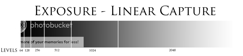

I didn't have time to elaborate on why under exposure is so bad for digital photos, but I can now.
Most of the image information is in the highlights.
Most of todays DSLR's can do 12-bit or 14-bit Raw captures and can capture at least 6 stops of light (dynamic range).
We'll use a 12-bit Raw capture and 6 stops of dynamic range as an example. 12 digital bits can define 4096 levels.
One-half those 4096 levels are contained in the brightest stop of a Raw capture, leaving 2048 levels. One-half of those 2048 levels are in the next darker stop of Raw capture, leaving 1024 levels. One-half of those 1024 levels is in the next darker stop of Raw capture leaving 512 levels, and we are half way through our 6 stops but only have 512 levels left having used 3548 levels in the brighter 3 stops of light.
There is significntly less image data in each successive darker stop of exposure. By the time we get to the last stop of dynamic range, it only contains 64 levles if data.
Next we need to consider signal-to-noise ratios. The stronger the signal (more exposure data), the less visible noise is, because noise is a weak signal. As the exposure signal level decreases with each stop of dynamic range, noise becomes more visible.
That is why noise is always more noticable in the darker parts of an image.
