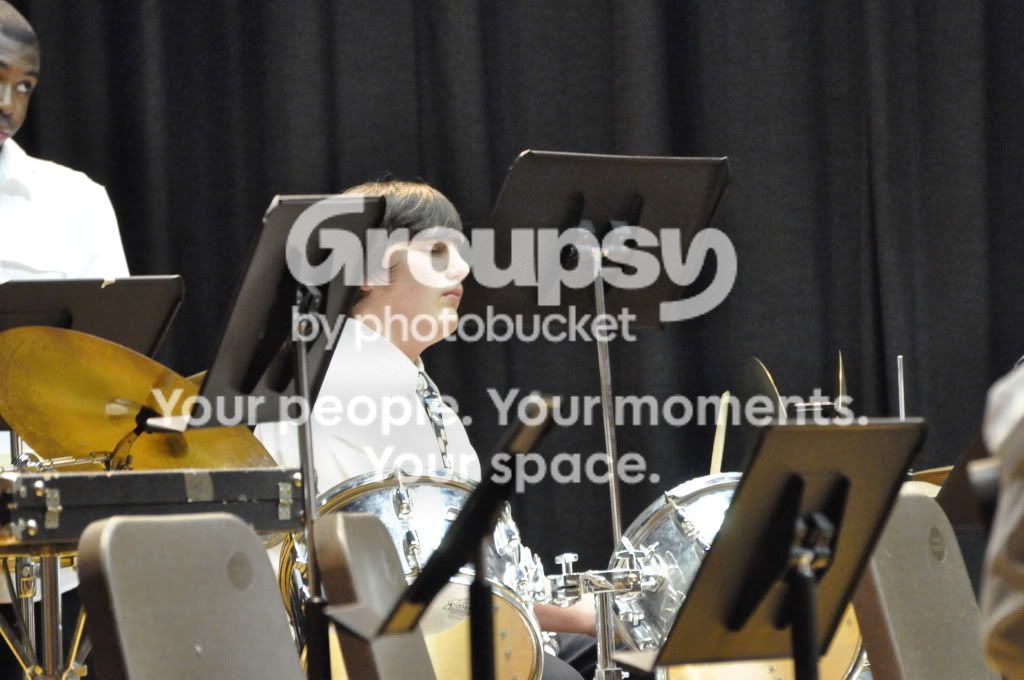

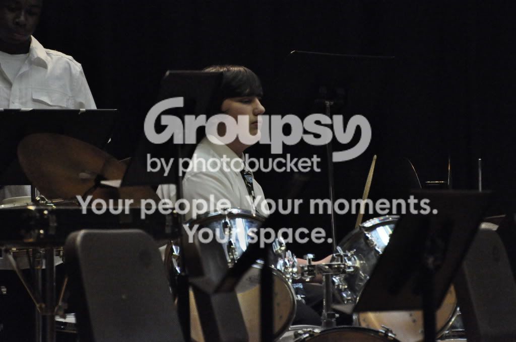

Here's three of the photos, but there's more that are over and underexposed.

Hm... looks like auto bracketing. Even smells like auto bracketing -- the earliest _DSC0047.jpg (second one posted) is the correct exposure, _DSC0048.jpg is the -ve (first one posted), and _DSC0049.jpg is the +ve (third one posted) which matches the auto bracket order...

DSC0047 - mouth area and the stand that's in front of him
DSC0048 - eyes and around the knot in his tie
DSC0049 - by the front shoulder and the curtain right above where the drumstick and drum intersect
