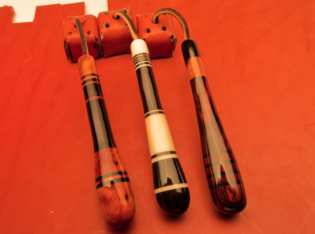

Here is a picture of my set up.
If you notice the white strip going around the bottom of my soft box , that is Velcro and its holing the linear polarized film on the bottom of the soft box.
I am using a TSE 17mm on a canon 5DmkII with a 145mm fotodiox CPL.
Because you are photographing polished metal and you have smooth black handles makes your product photography very specialized in the form of seeing a image in the reflections of the metal piece and glare that is produced on the handle by using light that is partially or is considered polarized light....
It seems I have allot better control of reflection when the camera is not at certain angle of the subject even on round smooth surfaced reflective objects !
Sorry about the lent in this photo it is embarrassing
Here is a photo taken almost right above the chalker's
and this is the reason I changed the angle that I photograph my products ...
