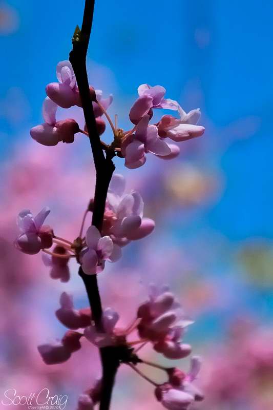

Ok on the first part Scott, I will keep reading, and trying the settings as I go. The second part, yes, exactly, I just want to have fun, I too have enough "work" to do. I really like your photos on your site. I have started a blog too for my photos. I LOVED this photo and have something similar I'll show you. At first, on mine, I didn't like how there was no top or bottom to the plant, but then it sort of "grew" on me, lol!! Then I saw yours a few minutes ago;) http://www.sc-photo-tn.com/wp-content/gallery/2012/foliage/2010-04-10-05.jpg
Here's mine that is sort of similar:) http://i556.photobucket.com/albums/ss2/nwcountry/newforSuzi.jpg
I wish I'd been into photography when I was in Alabama/Tennessee. That was one of the most beautiful places I've ever been! Thank you again Scott! Denise
