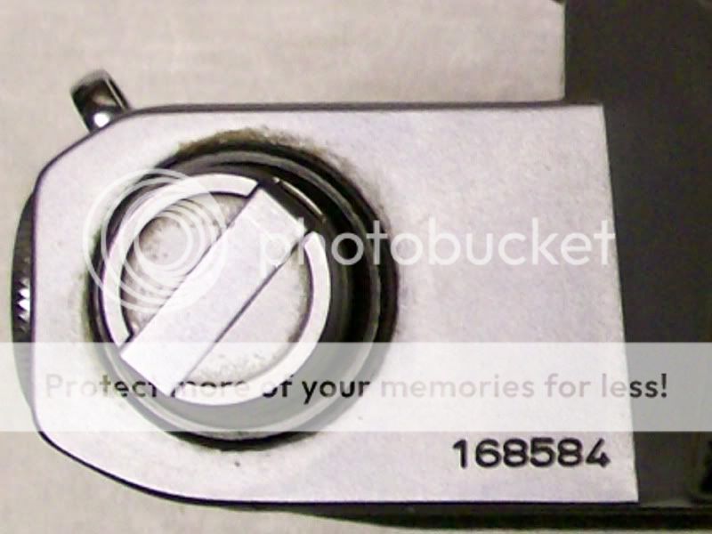

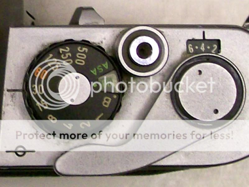

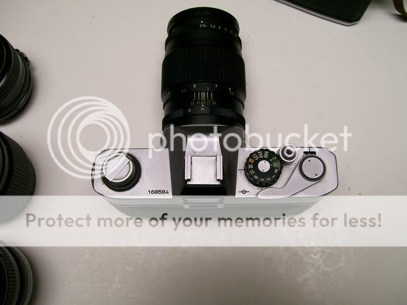

Could you post a picture of the top of the camera?
There is not much to see on the top of this camera but...
ASA/sh speed dial and advance lever
and the rewind nob
I've alredt figured out the advance lever and the shutterspeed dial appears to be the same so....It won't be long now.
