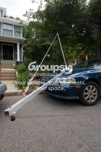

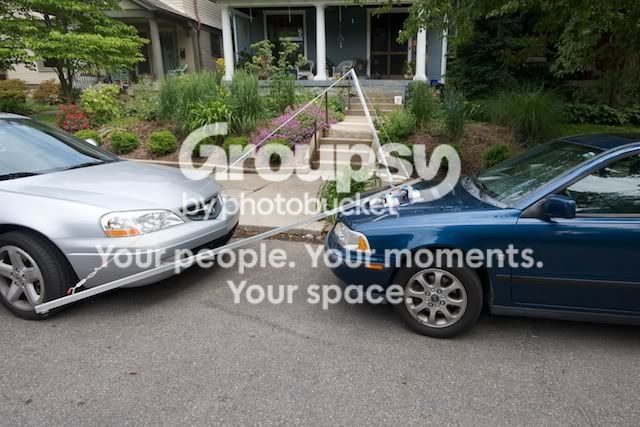

I built this rig the other day (summer break... way to much time on my hands) I was able to build it under $50.00. The only problem I'm having is a lot of vibration. I think it's because of the use of cheap suction cups. (there the ones "as seen on T.V." to help old people out of the shower) Someone who has built one of these rigs did you attach any weight to the end of rig (opposite end of the camera) I've only used it on my friends volvo. I'm so scared this thing is going to come cashing down dropping my camera. I'm trying to build up the courage to put it on my M5....

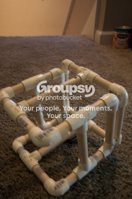

Here are some pics of the rig and this thing i built out of PVC pipe to help protect my camera.... i dunno if it will help or not...
Vibration is movement. Movement is transferred just like sound or light. It's a wave form.
To control it you have to isolate it. From what I see of above, you have a solid connection on your cable. Try to put a tension spring in it from like on a door. It's a compression coil spring with two brackets passed down the middle. The cable attaches to the brackets. The brackets then compress the spring allowing it a little bit of flexibility.
These are also used for tensioning electric fences on farms.
If you can create some kind of isolator bushing for the main arm where it attaches to the mount, that would seriously help as well.
I hope you didn't build it all for that Volvo.. ;)
That PVC contraption is just adding extra weight to your camera making it more likely that the suction cap fails. That is the real risk here. Consider adding counterweights. Suction caps will come off when pried off at one end which is what is happening with the distribution of weight. They don't come off by sliding very easily so a counter weight will go a long way to protecting your camera.

To reduce the vibration do not have the car power itself around, push it! You will need someone to push and perhaps a ND filter since you will be using a very long shutter. Additionally locate your suction cups near the edges of the body work, they flex WAY less.
I have a smaller boom on my rig so it allows me to drive the car will little vibration. Still pushing the car would have gotten me much better results than these taken two years ago....

A clean unwaxed car, a solid pole that's lightweight and stiff, and a good set of cups are what's needed. My pole is a bit heavy, but I use manfrotto avenger suction cups and super clamps on a pole I made from home depot. I wrapped the pole in foam insulation just incase anything were to happen. I've used this setup on several cars and have never seen paint or structural damage.
