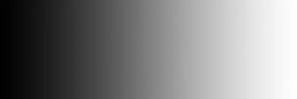

For example, here are two images of black white gradients:
The first one was generated as a 8 bit, then squashed into a smaller tonal range using levels, then expanded back out again, all at 8 bit.
The second one was also generated at 8 bit, but then converted to 16 bit mode, and the same edits were done.
Notice a difference? The bottom one is perfectly smooth still. In fact, if you were to make a 16 bit gradient in photoshop (I can't display one here, because the file uploader wont upload 16 bit formats), you would not visibly see ANY difference, because your eye is not precise enough to do so.
However, you can indeed see a huge difference vs. the first image, because doing your edits in 8 bit is lossy. When you smash down the tonal range, there aren't enough "slots" to hold all the data, so it gets banded into bins. Then when you expand out again, the data can't be recovered.
Bottom line: Editing in 8 bit creates banding and issues. But the original 8 bit itself is just as precise as 16 bit as far as our eyes can see. In the bottom image here, I didn't create any new data. I simply protected the sufficient data that 8 bit already provides.

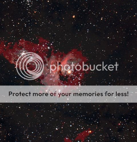

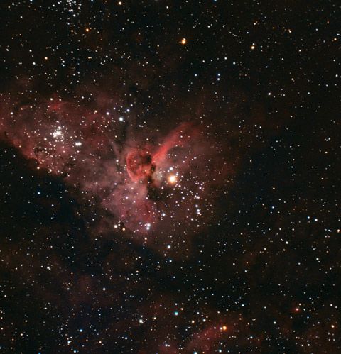

But hey why not do a real world example from my life:
Let's start with a perfectly exposed image of the Great Carina Nebula. Perfectly exposed as there's no clipping on black (noise) and only very slight clipping on one channel (24pixels on blue channel). I.e I can't shoot any brighter without clipping data.
Now lets process this bad boy but first convert to 8bit then back to 16bit.
Uah YUK. Lets try again in 16bit all the way through.
Not bad!
