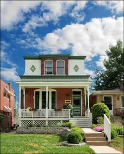

OK, got home and snapped a photo of my neighbor's Victorian house. Here's my version processed from the raw file:
Canon camera with the picture style set to faithful and the contrast set to -4 as you require.
Here's your JPEG: Victorian house

Okay here you go. Images wouldn't paste full size into the forum, so I made them both the same resolution as the raw one you gave me originally, and put them on imgur:
imgur: the simple image sharer
Click back and forth from image #1 and image #2 at the top of the screen.
Or look below (these are smaller for some reason than the imgur ones). My version from the jpeg on the left, raw version on the right.
These two images look radically different. Was that your intention? What I take to be yours seems to lack shadow detail, and has quite ugly artifacting on the small awning on the extreme left of the frame. The colors seem less appealing, as well, but that might be simply that you like more saturation.
Both the shadow and highlight detail in the raw version are better, and it is not difficult to see the difference. The clouds in the JPEG version have featureless patches, and the shadows are blocked up. Many of the mid tones have that 'stretched too much look'.
