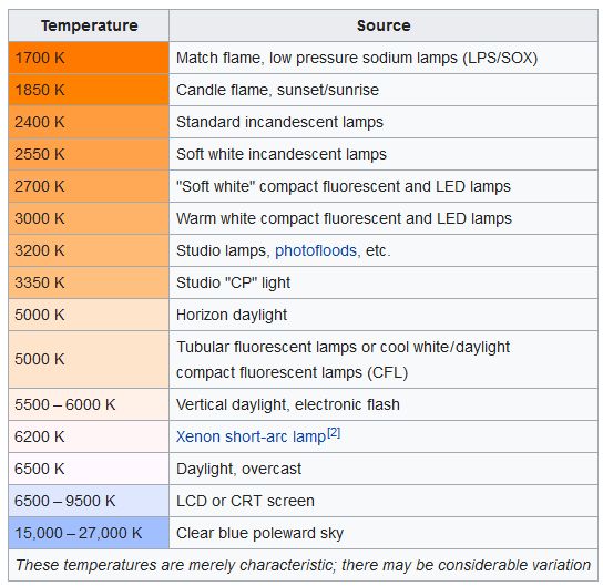

Jim, Can you explain simple terms for a layman, the difference between White Balance and Color Temperature? How do they inter-relate? How do you know which one is correct or incorrect?
@AlanKlein I learned yesterday that you and a friend of mine are neighbors.
I'm not Jim, but I use Understanding White Balance explanation, where WB correction removes the unrealistic color casts so that objects that appear white in person, appear white in your image. Color temperture describes the spectrum of the light (color). In person, your brain automatically corrects, it knows white is white, so you see white. A camera records reflected light, making no such adjustments.
As to how I know it's correct, it depends on the degree of accuracy I need. For every day stuff I use my eyes. For more precise work, I use a Colorchecker. It's important to note that before you set the WB you should adjust the exposure to a full histogram (Not blown or underexposed). Once you set the WB then set the White point and Black point.
