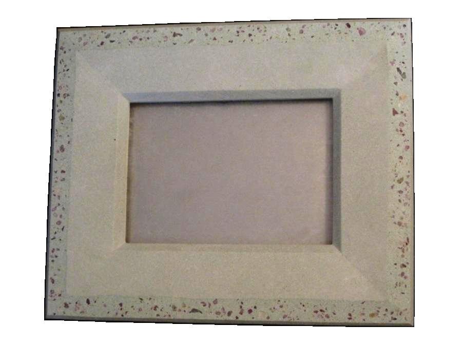

Has anyone ever heard of framing their work in concrete?
I started making concrete picture frames for my diploma and then for standard size prints. I have made custom shapes and sizes since then and have lately been looking around for any feedback or new ideas.
Here is an example of what a 5x7 frame looks like:
Thanks for looking and for any comments.

All right guys, thanks for your questions and comments. Let me try to answer some questions:
The 4x6 weighs about 1.5 lbs.
The 5x7 weighs about 5.5 lbs.
The 8x10 weighs about 7.75 lbs.

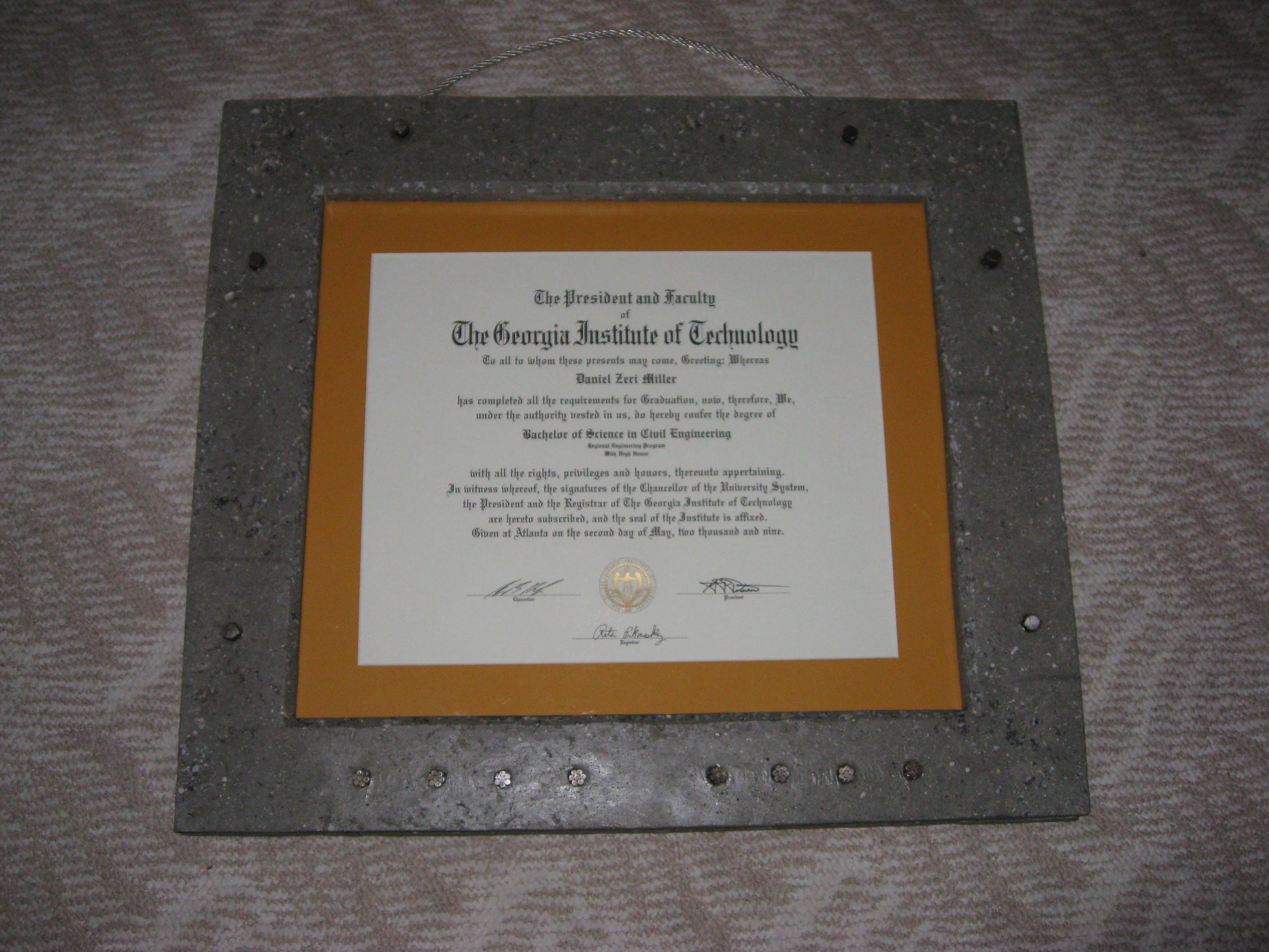

My diploma (BSCE) was 17x14 and the frame resembles a cross-section of a bridge box beam with projecting rebar and prestress strand. It hangs on my office wall and weighs 55 lbs.
I use my own mix with compression strength of over 8000psi. I am a structural engineer and work for a concrete bridge fabricator. My last 4x8 cylinder test with my mix was 8479 psi. I don't see any need to improve that. Ready-mix can't touch that :razz:. I also use fiber reinforcement and super P. The stronger the mix, the less mass you need for strength. That is how I keep the weights reasonable.
I have used colored cement, rock and sand. I will be playing with additional pigments and stains soon. I have not heard much about the cloth, but it sounds like a great development.
I don't mind others making their own. My boss and I came up with the idea because I was too cheap to buy a $200+ wood frame for my diploma. If muddy messes are not for you, I sell them online and do custom work at concretepicture.wordpress.com.

This is what my diploma frame looks like:
I also like this idea. The frame design can be well varied. The higher PSI is also clever, I do not know how an average individual can get that type of mix though.
What about using a thin wire mesh to help make them smaller with less weight?
Pierre, the wire mesh is a good idea. It would strengthen the frame. I have done a bit of research into fiber reinforcement where I work and another possibility is steel wire fibers. The 5x7 frame is only 3/4" thick. I get a lot of comments about the picture of my family sitting on my desk framed in concrete.

I work with the plaster and drywall trades. I somehow end up with concrete trade catalogs (mostly because they also contain drywall and plaster tools) and I've seen a product that's just loose fiberglass fibers about 4" long. Supposedly you add it to concrete for walkways and such to strengthen it. That might work and not add the weight that steel would.
