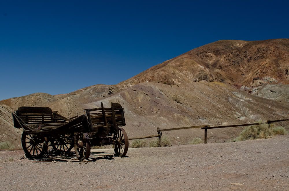

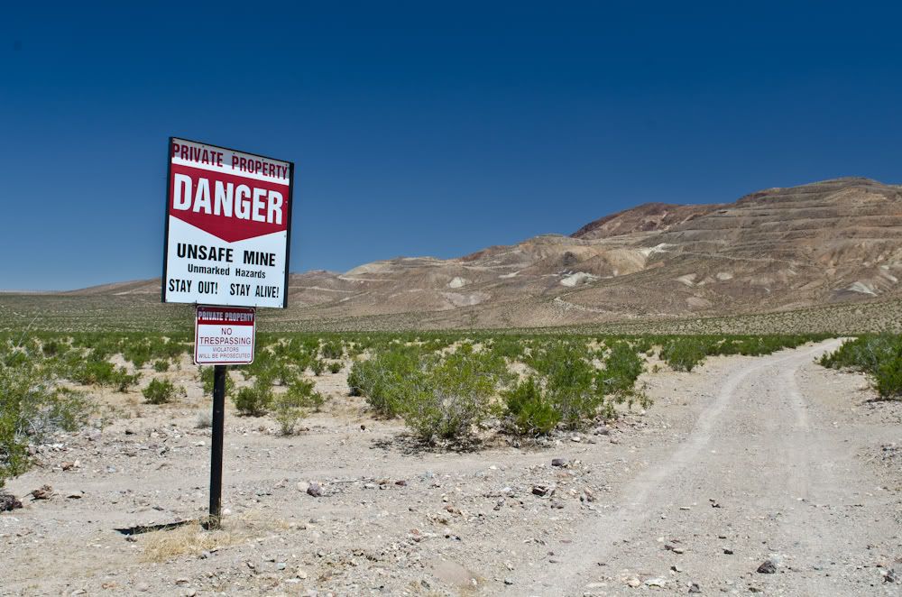

I'm traveling across the country on a bike and the sun in the desert out west here at "high noon" is brutal and I can't wait around for golden hours as I go.
I bought a B&W CPL in Vegas to help with at least "snap shot" quality photos to remember the trip.
As I was shooting between Vegas and LA, I noticed with my 24-70 lens my pics aren't as sharp when I use the filter?

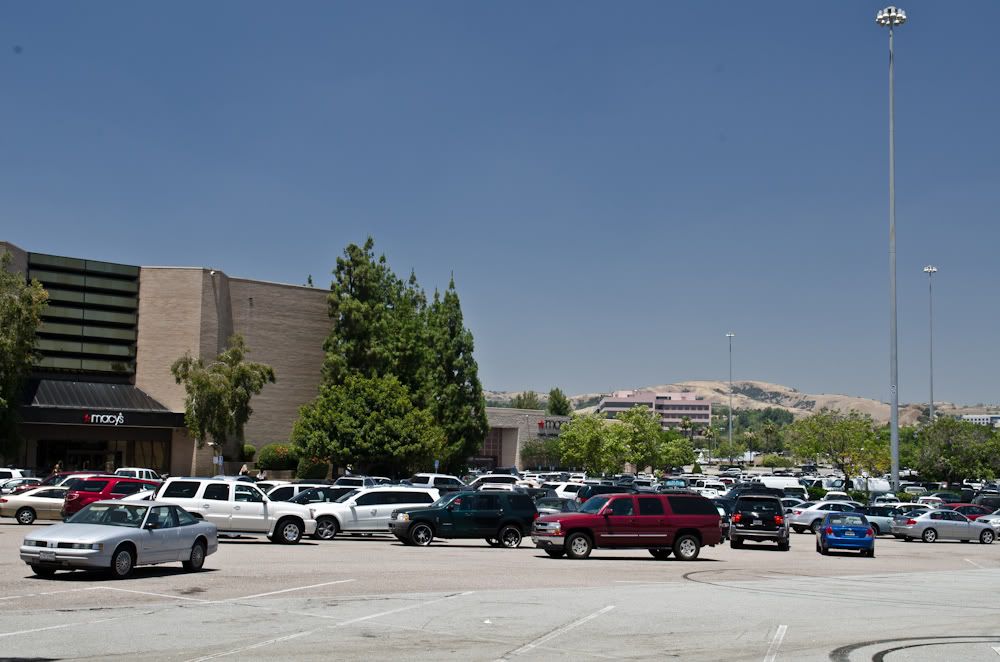

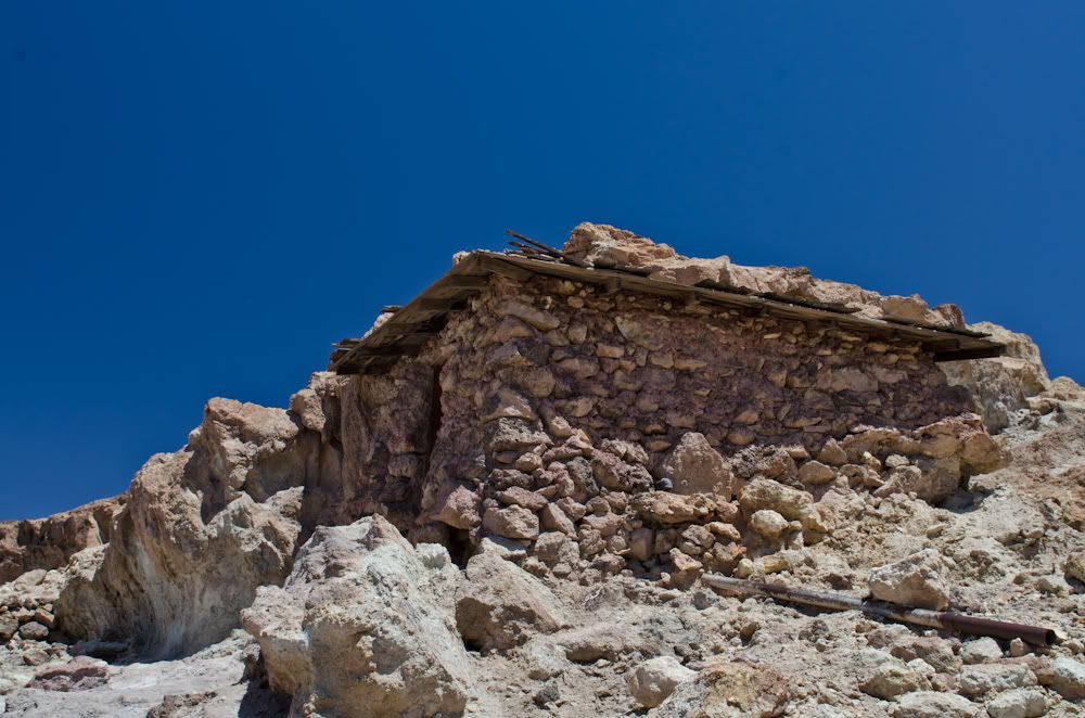

Any suggestions? Here are 5 examples, 1st 3 are the pics I wanted to take for trip keepsake of stuff in the middle of nowhere. The next 2 were taken in a parking lot just trying to figure out WTH is going on (one at a big aperture and one at a small).
Any advice will be appreciated, I know I'm screwing it up and can't figure out how. Thanks from an FL boy in Sunny Cali!
Parking lot pics:
The best way to determine this is to shoot the same subject with the same settings, on a tripod, one without the filter and one with the filter. Then take a 100% crop of a detailed area. I've never noticed any loss of sharpness with my B+W filters.
I'll try that, didn't think about doing that. It just seemed so obvious, I've shot a lot of pics with that saqme lens so far on this trip and as soon as I popped that filter on they went soft.

Well, that additional information makes me think it's a genuine B+W filter...the filter world is FILLED with cheap-o, off-branded filters, some with names that are efforts to trade on well-known names. I'm not sure why it is, but it seems to me that short focal length lenses seem to reveal defects inj alignment on low-cost polarizers, more so than longer focal length lenses. Of course, the evidence I have is my own experience, anecdotal,and of limited sample size; I had a Hoya polarizer I used with my Nikkor 24mm f/2.8 Ai-S wide-angle and other Nikon wides in the mid-1980s. The 24/Ai-S is known to be an excellent performer; however, with the HOYA POLARIZER, it shot like utter crap. Just total garbage. I mentioned that to my photo dealer at the time, and he set me up with an over-sized Nikon polarizer, which I still use to this day on my 24...problem totally,totally solved...I never used the Hoya again.

****edit I see the question above - I'm shooting hood off so its easy to turn the filter. Is that just wrong in this desert sun and hosing my pics?
I'm a huge proponent of using the lens hood. You can run your finger on the inside of the hood until you reach the filter ring and then slowly turn. If you have stubby fingers, this may not be so easy with a long hood like a 70-200mm lens though. A light fingerprint on the edge of the filter won't likely be seen in your image.
Thanks-
It's VERY possible. It will decrease contrast at the very least and possibly mess with auto focus accuracy - particularly with all reflected desert sun.
