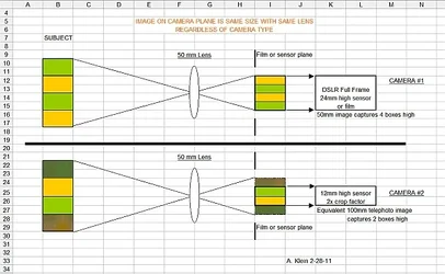

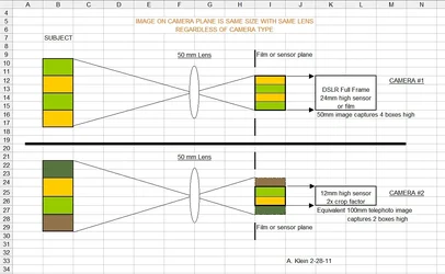

Here's a little graphic I made to explain crop factors to myself. It shows how the same lens will double the telephoto zoom appearance on a 2x crop factor camera. Maybe it will help you.
Both graphics are the same - only the size is different. Somehow I posted both.
