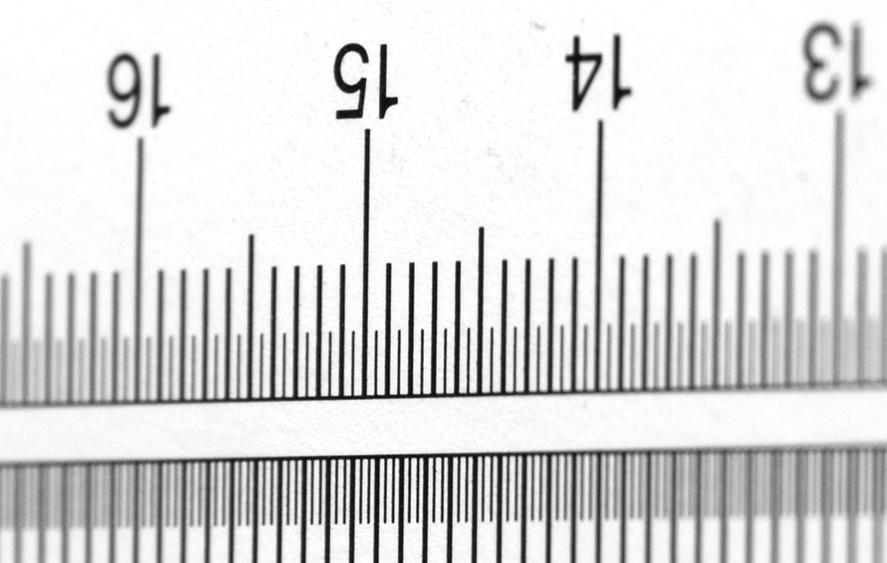

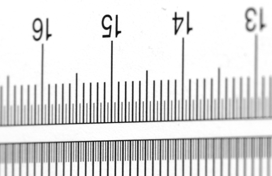

I cannot give an example for the first situation yet, but I can give you an example for the second one:
Same lens 70-180 mm Zoom-Micro-Nikkor, same aperture f/8, same focal length 180mm, same distance 0.72m, same angle 45 degrees, same crop at 100% magnification.
Different cameras:
D3
And D300
Focused on 15 bar. Credits - Nikon D3 Reviewed. FX vs DX formats
May the light be with you !
You are still misunderstanding this. Please carefully read what I wrote. The example you show demonstrates one of the statements I made, and contradicts nothing I have written. Please note that at the outset I stated that the DoF comparisons I was giving were for when the final image is presented at the same size (using the full size of the initial image). The example you show is for the same final magnification (subject to 'print') - this is a different case. It may sound complicated, but once you understand how and why the maximum CoC criterion is arrived at it becomes clear.
I'll reiterate the fact that the CoC is chosen for the format. Lenses are indeed designed for optimum performance and coverage for a particular format, but this has more effect on their maximum resolution and may have no effect on DoF, simply because DoF is all about objects that are not in perfect focus.
Even within a format it is often advisable to use different CoC criteria for different situations. There's little point in setting the maximum CoC to a value significantly smaller than the size of a photosite, for example. The more the format is magnified to the final image, or the higher the resolution of the recording medium the more likely it is that a smaller maximum CoC criterion will be justifiable. This is also noticeable in film - I shoot large format for both magazine covers and for very large prints, and I can use different CoC criteria for each application. Same with 16 mm film - we had to decrease our CoCs for the same lenses as film improved.
Best,
Helen
