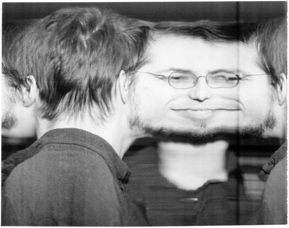

Andrew Davidhazy exploits the same effect using a modified Polaroid to get images like this:
The lens is replaced by a vertical slit and a string is run from the film tab to a small motor. When the shutter is pressed, the film is pulled past the slit. I was standing on a turntable rotating in front of the camera.
