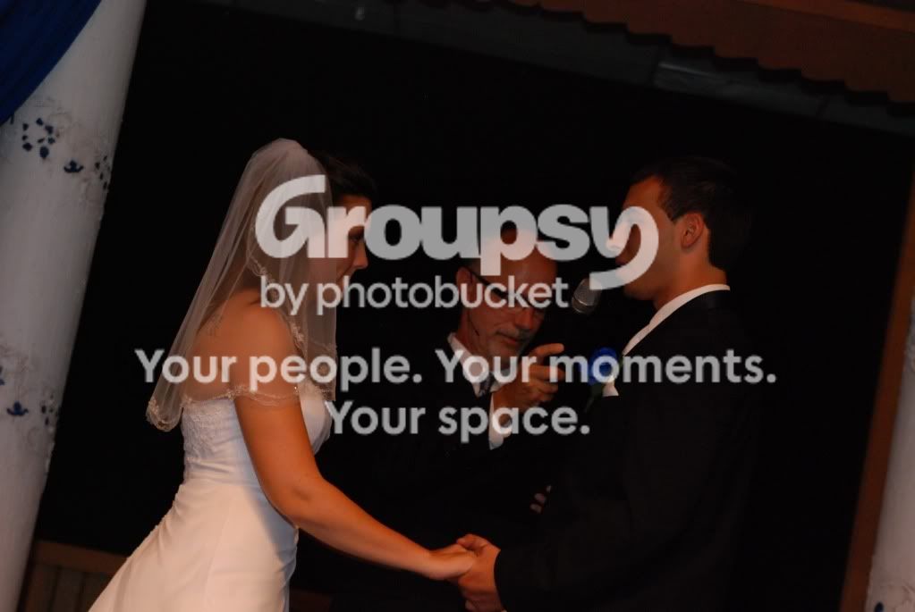

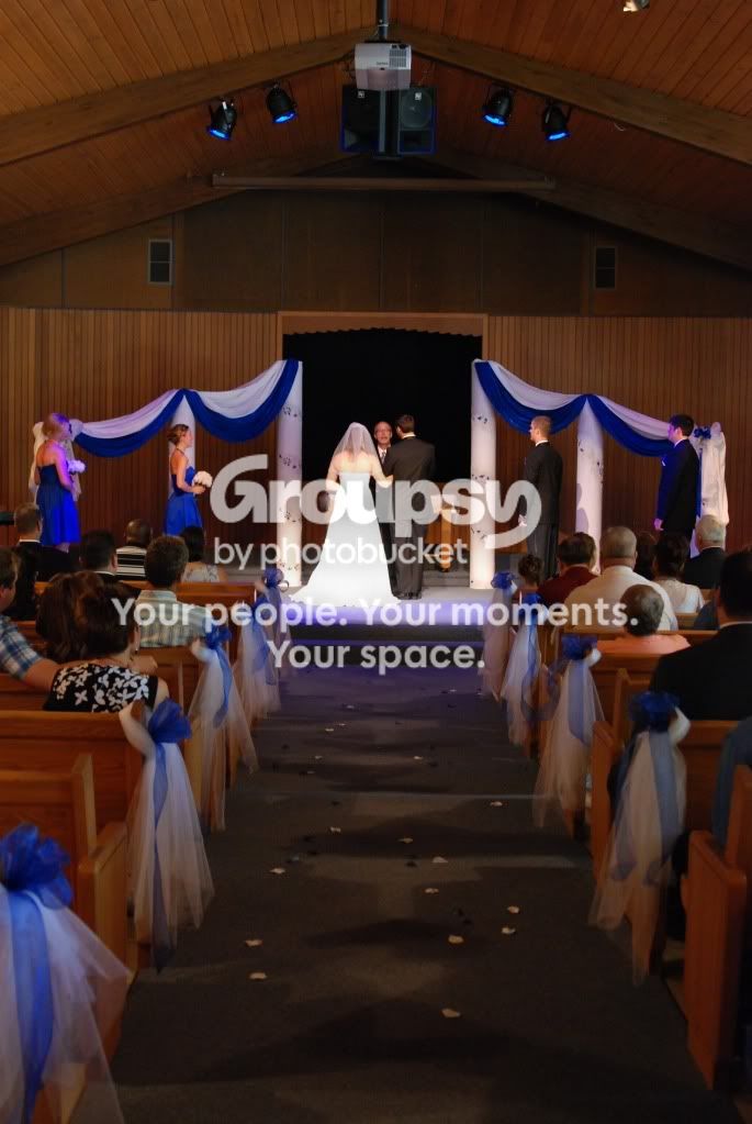

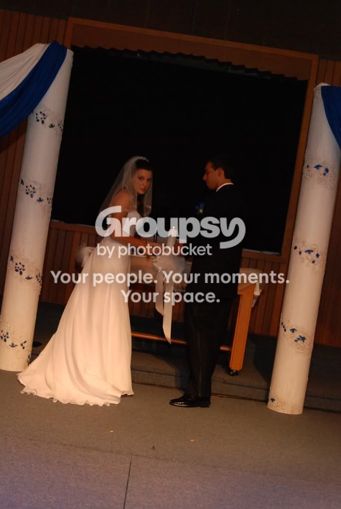

Ok, so this church was nice and dark . . . you would think representing the pearly gates they'd be a little brighter, but anyway . . .
I'm still learning to adjust light after I got over my fear of the manual setting.
It looks like there is a fairly wide gap in lighting different parts of the church vs the bride and groom. I'd try to expose for their faces and let everything else fall where it may. The first image looks like it's a little overexposed for their skin. The 2nd and third images look a little underexposed on their faces. If you're already at 2.8, I'd adjust the ISO as a first choice and shutter if needed (but only if you're using a tripod).
The reflected light meter in your camera should have indicated the photos would be underexposed (dark) before you released the shutter. The image EXIF data shows no exposure bias was set so the meter would not be biased to underexposure. Do you know how to use the light meter in the camera's viewfinder when you are shooting?
The image EXIF data also shows you had your D80 set to Matrix metering. You have much more control if you use spot or center-weighted metering. See page 52 of your D80 users manual for an explanation of the D80's three metering modes.
On an unrelated note, the camera was far from level in any of the photos you posted.

Ok, well metering is where I need help. I promise, I know how to take a level picture. I think I was going for "cool" angles before I got my lighting down. I won't do it again :P

They all seem a little blurry.. Were you using any sort of tripod or monopod?
