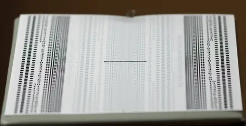

I have full frame and APS-C bodies, and prime lenses, so I got out a tripod, a target and a tape measure. Sensor size has no effect on DOF.
Sensor size lets you move the camera to frame the scene to match the other body... which changes the parameters that affect DOF. That's a totally different experiment. You can put a 10 mm lens on an APS-C Canon body and a 16 mm lens on a Canon full frame body, and the framing will look the same. View both at 100% and the differences become evident. If you have two APS-C bodies with different photo site densities, you can play other games too. Much attention has to be paid to how the question is framed, and how the reply is framed, or the results can be misleading."
So, during some limited free time this week, I stuck a target on a stool. Put a Sigma 150 mm f/2.8 macro lens on the tripod, and took photos with two different APS-C bodies and a full frame body.
Some random web page that had dimensions said: APS-C is 22.2 x 14.8mm (Full Frame is 36 x 24mm). I don't know without looking in a manual if that is the correct measurements, but it suggests APS-C sensors are about half the size of a full frame sensor. If there is anything to the argument that moving from APS-C to full frame , without doing anything else, affects DOF, it should be readily apparent.
Here are 3 photos, screen captures, to ensure all EXIF data was removed. Which photo is from which body?
........................... A ..................................................... B ............................................................... C ................................
These were all taken through the same lens, at the same aperture, at the same distance. If you see an obvious difference, please tell me which of A, B or C is from the full frame body.
View attachment 87387 View attachment 87388 View attachment 87389
Going to take a guess here. Is A the full frame?
