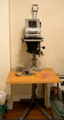

For a couple years, I set a sheet of plywood on my bathtub and used that as a 'counter'. Yes, way too low to be sure. But functional for the enlarger and trays.
I did similar in one of my apartments, a partial sheet of 1/2 inch plywood over the tub for the enlarger, and it worked out quite well.
I just sat on a foot stool while I worked on the enlarger.
I built a portable counter extension that fit over the toilet, where I had some of my trays. I don't remember but may have used another plywood sheet, over the tub for some of the trays.
If you are resourceful you can do a LOT in a small bathroom.
In my current home, I use a small half bath as my darkroom . . . to print.
Small Durst M600, 6x6 enlarger on the toilet.
Rocking print tray or drum to process the print = minimal need of counter space.
Washing is done in the nearby kitchen.​
Film developing (35mm and 120) in comparison to printing is easy.
The only issue is finding a DUST-FREE place/enclosure to dry the film.​

That was kind of the point of my first post. So, lessee; we have an enlarger, which has a certain footprint, you will need three trays probably close by, some storage space for your papers and chemicals, a timer, a little bit of space for your tongs, some place to hang the prints to dry, the safelight usually hangs on a wall, and maybe a paper trimmer.
Visualize that setup somewhere in your house, and you'll know if you need to add a room. :D

When you use an enlarger, make sure you have room for 4 trays. I use three trays and a tub of water, but you need the foot print for 4.
