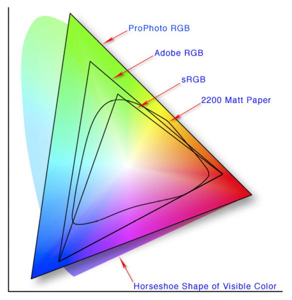

Adobe RGB has a broader color gamut than sRGB has, particularly the greens - Color space - Wikipedia, the free encyclopedia
In this illustration you can see the additional green tones Adobe RGB has in it's color gamut that sRGB lack. This illustration also shows the ProPhoto RGB color space's gamut which actually includes some colors humans cannot see. Many image editing experts recommend editing in the ProPhoto RGB color space, and then converting the image colorspace to a more appropriate color space based on image usage.
