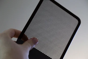

One of them had nothing in front of the lens. The other had this covering up the entire front element:
Can you tell the difference? Probably if you squint hard. If you weren't looking for it though, you probably wouldn't. And that bookend is the equivalent of HUNDREDS of little pieces of dirt.
