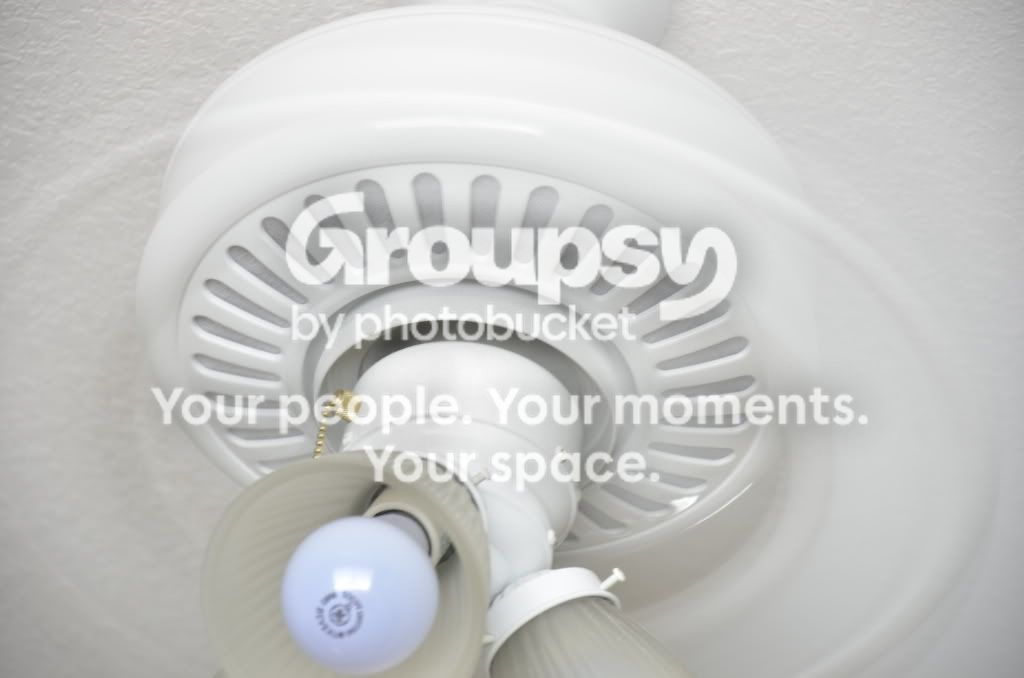

I'm having some trouble understanding the exposure compensation or +/- EV on my camera. For the test shots I used a D7000 with the 18-105.
The manual says it increases or decreases brightness and shows 3 pictures of a setting at -1,0,and +1, with all the photos changing exposure.
My question is, when I change the EV, and don't change any other setting, nothing changes in my photos, except for the meter? Is this whats supposed to happen?
Here are my examples to show what I'm talking about.

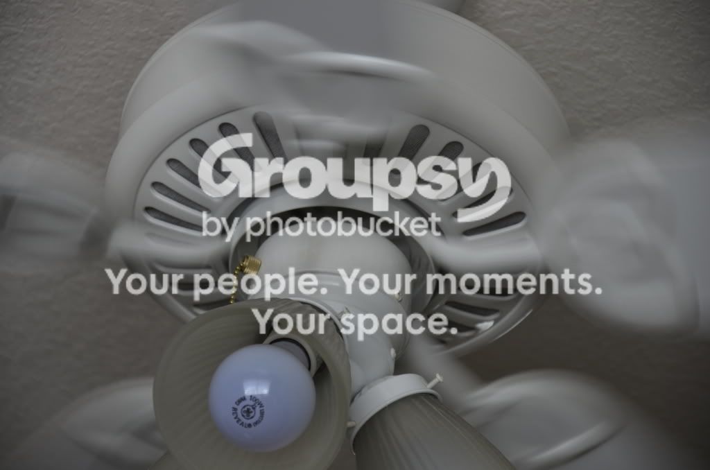

1/50 @f5.6 0EV
1/50 @f5.6 +2EV

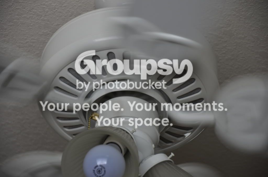

Here is when I changed my settings to get the meter at 0
1/8 @F5.6 +2 EV
Is this what it's supposed to do? It doesn't seem like it makes any difference to me besides changing the meter. The first two pictures look the exact same to me.

What is your shooting mode? EV Comp won't be effective when shooting in Manual.
EV refers to the number of stops.
When you tell your camera to shoot EV +1 it'll up the shutter (or increase the size of the aperature) by one stop depending on how you're shooting (aperture priorty / shutter priorty / etc)
1/50 to 1/8 is maybe 2 or three stops (not sure of exact number), so actually your last photo and first photo shows the difference
Oh.... I'm shooting in Manual... Guess theres the answer! haha thanks!
Exposure compensation always moves the meter. The only difference here is that in any of the automatic modes the camera adjusts it's settings to hit the meter dead in the middle.
In A priority exposure compensation changes the shutter.
In S priority exposure compensation changes the aperture.
In Manual exposure compensation changes only the meter (since now you can adjust settings off your normal metered value) .
The only exception is if you enable AutoISO. Then in Manual mode the camera will adjust the ISO to match the meter if possible.
