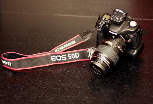

Oh, and no Gerry, I have not modded the transmitter yet ;)

BTW, if and when you mod your cactus transmitter, make absolutely sure that you use the right length of cat5 single strand copper wire from a piece of networking cable. To get the external cases, like I have with my receivers, on your next trip downtown, go to Addisson in Montreal and get them for well under a dollar a piece.

It is going to be a bugger to measure the wire to exactly 12-25/64" to cut it to length!! I am assuming being off by a 64th or so won't be too big of a deal?

Being off a small amount won't set your transmitter on fire, no... lol

When I got my Trigger set the consistency was very crappy, I figured it was due to the original batteries, so I went ahead and did the antenna mod, and right away, even with the old batteries I had perfect consistency and was firing my flashes from about 150' I only stopped there because I ran into a wall. I think that most misfires and inconsistency that people run into is resolved by adding the antenna.
Thanks Ryan!
I'll be doing the "Jerry Special" mod as soon as I can borrow a soldering iron. I already have the wire.
