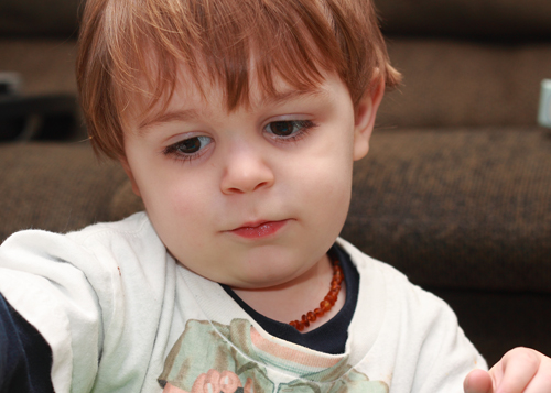

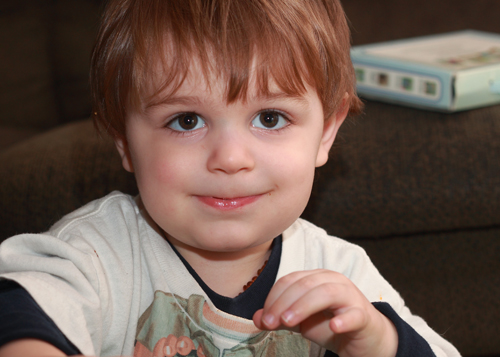

Ok, rather than starting a new thread, I'm just going to add tonight's experiments here. :) My subject was a little less cooperative, but I still got to play around with the flash a bit. I tried a bunch of different ways, but I'm just going to post two. They were both ISO 100, shutter 1/200 and something like F4. I can't remember exactly and I have an unhappy toddler clinging to me. Neither has anything but very basic PP done (sharpening, etc. before converting to jpeg).
This one, I bounced off the ceiling between us, with some white cardstock rubber banded on. It was about 1/2 inch past the top of the flash. I didn't get any catchlight in his eyes, even with the cardstock. :( The lighting seems flat to me.
This one, the light is bounced off his off-white highchair about 45 degrees to the right. I need to get real reflectors. (My birthday is coming up and my parents are getting me photography stuff, hopefully including a reflector. ;)) In spite of being a highchair and not a reflector, it did bounce the light pretty well. I liked this one better because it gives shadows and showed more details.

You almost never want to bounce on the ceiling between you and the subject. You want to bounce it to the back. I know it sounds silly because if you bounce it to the back doesnt seem to be bouncing to your subject but it does. The only time you want to bounce it between you and subject is when the subject is far away from you. So try again bounce it to the ceiling behind you (flashead about 45 degree facing back) and try to shoot the flash to the side a little.

The next thing to address, is the direction of the light source. If you bounce the light directly on the ceiling above, you have a largish light source shining directly down on your subject. Chances are, the eyes will be in shadow (the famous raccoon eyes). If you bounce the light directly behind you (assuming there is a white wall there), then you will get relatively even but flat lighting. If you bounce the light on a side wall, then you will have a light source what is large but lights your subject only from that side.
Another way to deal with this is to use a reflector instead of a wall. The reflector could be a white bedsheet, or a large white cardboard, etc. You’d have to think about the direction of light you would want to illuminate your subject, then arrange to position yourself, the flash, and the subject so that the flash bouncing off the reflector would give you the end result. Yeah, that’s a lot of contortion. Which is why off-camera flash is popular with photographers. The flash unit is set up to do its lighting job, and the camera is moved around to take the picture from the right angle. But now you need a way for the camera to trigger the flash, and to figure out the correct exposure… OK, we’re probably not there yet.
Back to bounced flash. Find an unobstructed corner that is painted white. For the purposes of this thought exercise, locate it on your right about 4-6 feet away from you, and about 90 degrees to your right (0 degrees is directly in front of you, 90 degrees is on your right, 180 degrees is behind you, and so on). Position your subject on something comfortable in front of you. Aim your flash head (of your on-camera flash) towards the corner. Focus and shoot. Since you lit the corner, the light should be partly on the side wall and partly on the wall behind you, and should give you a large soft light, but still with shadows. Move around until you find a combination of distance from the corner, and angle of flash that gives you the results you want.
This one won't angle back. :( It only goes as far as straight up.
Only 90 degrees. :( I only have it because my dad upgraded and gave it to me.
