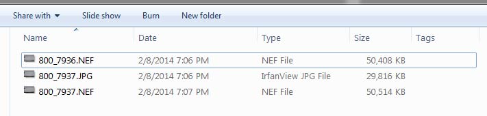

The camera actually embeds a full sized JPEG in the RAW file, as well as a small version for preview on the LCD.
I cannot see inside the NEF file, but I don't see any evidence of that.
Here is NEF only, and NEF + Fine. On fixed tripod, on unchanged subject.
First line is NEF, followed by NEF + Fine. Second NEF is 106 KB larger (why, I don't know).
If the JPG is 30 MB, and if it is in there, why isn't the second NEF 30 MB larger?
