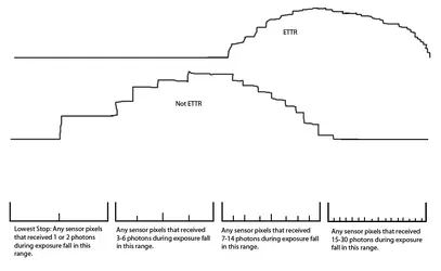

Here's a little graphic I drew up. This is a toy example of a hypothetical camera that has 4 stops of dynamic range and 5 bit depth, using individual photons as exposure for simplicity.
The X axis represents the range of the camera, similar (not identical) to the X axis in the histogram you see on the back of your LCD. It is scaled by stops.
5 bits = 32 discrete luminosity values possible (let's say 0 = "no photons during exposure, blocked shadow". 31 = "more than we can detect, blown highlight"). They are NOT divided equally across the range.
The top stop of dynamic range has 1/2 of all the lightness values the sensor can detect, but is only 1/4 of the range, since stops are logarithmic.
Above are two examples of histograms. Normally the LCD screen doesnt have the resolution to show you these differences, but our low bit depth example makes it apparent. One is not exposed to the right. Notice that it has less information and is blockier, because most of the image is falling in the low-precision part of the range. Whereas the one exposed to the right has much more data in it, because it's using the higher precision part of the range. You then edit it in RAW with all this extra data to your liking, then digitally stop back to a proper exposure.
TL;DR: You'll get more posterization if you expose the same image to the left of the histogram than to the right
AFAIK, this is all still as true of modern sensors as older ones.
