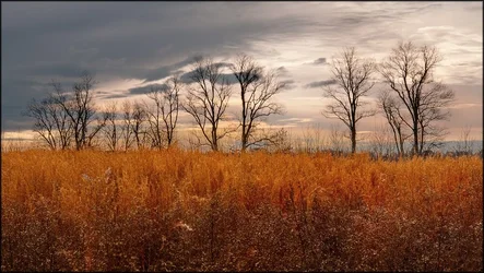

Getting land and sky into the same photo has been a problem since literally the first days of photography. There are a lot of ways to skin this particular cat. All can provide excellent results. Arguing about which one is "better" is silly.
Your method may be better for you, indeed, I rather hope it is, but if you think it is objectively better, you are just wrong.
Sunset.
No ND filter.
No multiple exposures.
No HDR or exposure blending.
Just a processed raw capture, and an old 12 bit one -- can do better now with newer tech.
Joe

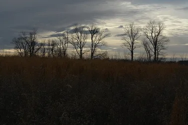

edit: Here's the camera JPEG for reference.
[QU OTE=Ysarex;3259002]View attachment 77233
Sunset.
No ND filter.
Joe
View attachment 77234[/QUOTE]
While a good example, the exposure difference between sky and foreground is minimal. You could never do this with a 5 stop difference, which is what I often encounter.

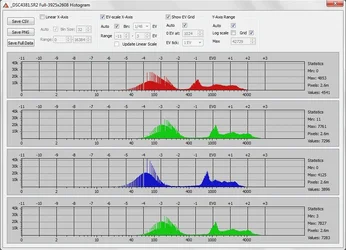

The exposure difference between the highlights in the sky and the shadows I lifted is 6 stops (see histogram). And that's old 12 bit tech. I can do much better now with the 14 bit A/D converters in my modern cameras.
Joe
