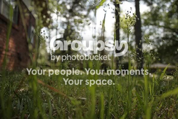

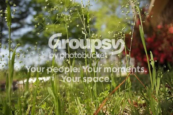

I'm posting two examples below. Both were taken a few weeks ago, both were outdoors, and both were in the same location. These were actually just test shots, so no C&C required, as they're not meant to be good. I was mainly trying to see if I could focus in on these small weeds, or whatever you'de like to call them.
Notice in this first shot.... the sun is out in full (late afternoon), and the exposure seems dead-on to me. You can really see alot of detail in everything.
Now for the second. This shot was taken almost in the same spot, but turned around completely, heading in the other direction, but a cloud had went over and provided some shade.
Now to me, this shot is under-exposed, with hardly any detail at all, but is that true? and if so, why? According to my camera, it should be perfect, and I know that the shade did this, so does that make it a simple lighting issue that can't be fixed? Would it be fair to say that lighting and exposure are the same thing, or at least, very close? I was using a polarizer for both of the shots also, could that have helped make this happen?

Well what I see, is that the first one, there isnt much sky or bright spots in the picture, even though the sun is out, where in the second there is a BIG patch of the bright sky directly in the front. The camera probably took that for the metering and therefore underexposed for the part you wanted. Generally if your taking a picture of something, and there is a bright sky i view, but not what you want the picture to be of, overexpose a stop or two.

Your camera probably has 3 different light metering modes, small spot, larger spot and matrix. Which one do you use?
In your second image, with the aperture you used there is just very little in the scene that is in the DOF range. Also you have a very bright background sky that the camera is trying to expose for which is why your foreground is underexposed.
The camera is only a crude approximation of your eye and the electronics are not really all that smart. In this case the way to have gotten a proper exposure was to spot meter the sky and use flash to illuminate the foreground and keep both in balance.

Exactly. But the way you describe it, the sky would need to actually be in the final composition (imagine a typical landscape shot). If you did that, then took a picture of a flower at your feet, it would probably be under-exposed.
If you had looked at the meter for the second shot (you probably didn't even notice it, since you just set it up) you would have noticed that when the cloud passed overhead the needle was slightly on the negative side of zero.
Direct sunlight and shade may not seem like a big difference to you, but it is to the camera. In this situation you would have had to zero your meter out again to get the same exposure.
So, if one can "expose for the sky" can one "expose for the shade"?
Yes, and that is what you should have done on the second picture. You could just point it at a shady patch of grass and zero your meter out on that. Now anything in the shade will be exposed properly. Sunny areas will be over-exposed though. For that, meter on a sunny patch of grass.
