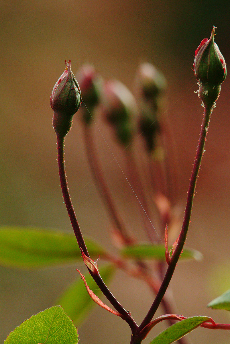

I have used tubes on the Nikkor 80-400 VR, which does NOT focus very close! A 12mm and a 20mm proved to be the two most-useful tube lengths. Kenko AF tubes for Nikon; if you shoot Canon, the Canon 12mm or 25mm Canon-brand tubes are VERY solid. ROCK-solid tubes. But do make sure to support the LENS from underneath!
Here is a 6MP shot I made nine years ago, using the 80-400 and a tube.
These are rosebuds from my climbing rose,which is now as tall as the house is. It blooms but once a year, with hundreds of fragrant pink blossoms. I was trying out the 80-400 VR lens with a 20mm Kenko extension tube, and to my delight, this tube preserves the Vibration Reduction feature of the lens,and for some reason,I had just assumed it would not!
This little spider web marks the spot where I suspect the very first roses will bloom! Since the 80-400 only focuses down to about eight feet, an extension tube is a real boon for doing very close-up shots,at up to 400mm focal lengths,which on a 1.5x body,is like having a 600mm lens that focuses down to well under eight feet....pretty much unheard of. Now that I realize the Kenko AF extension tubes preserve VR with this lens, I think I'll start looking for more opprtunities to use the 80-400 as a closeup lens! At 80mm setting,the lens focuses down to a measured 22 inches with the 20mm tube. At 135mm it focuses to about 38 inches,and spans left to right an area about 4 and a quarter inches with the camera in horizontal mode. To answer Lisa's question, this was hand held and no tripod was with me.
FujiFilm FinePix S2 Pro ,80-400 VR Nikkor +20mm extension
ISO 400 STD-ORG-OFF 12MP FINE 299mm f/9.5 @1/125th 80-400 VR + Kenko 20mm AF Extension tube with VR enabled
