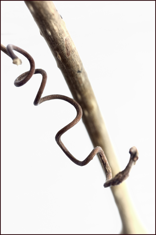

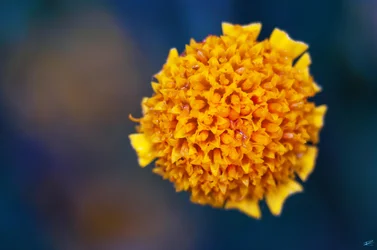

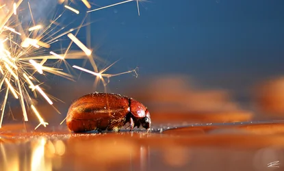

Here are a few examples used with the very cheap kenko extension tubes. They are the ones with no metal contacts, which means to aperture control. But I found a way to get around that. Instead of turning the lens all the way when you attatch it. If you watch through the front of the lens while attatching it, you will see the aperture moving when you turn the lens, so on my 50mm prime, I just turn the aperture ring to the size I want it to be and then turn the physical lens until the aperture closes to the desired number.
I should note that I shoot Nikon. But the principle will still apply. ( I think)
This one was taken with three extension tubes all stacked up, and a 55-200 lens mounted. (what I found quite nice about this lens, is that you can focus with the zoom. Which is very nice if you have a small focus ring like the 55-200 has. External flash right.
This one was also taken using the 55-200. Flash mounted in hotshoe.
This one was taken using the 50mm prime. Three extension tubes if I remember. External flash above.
This one was also taken using the 50mm. Flash mounted in the hotshoe.
Also taken with the 50mm, again flash in the hotshoe.
This one was taken with the 18-55mm Lens with only one extension tube attached.
