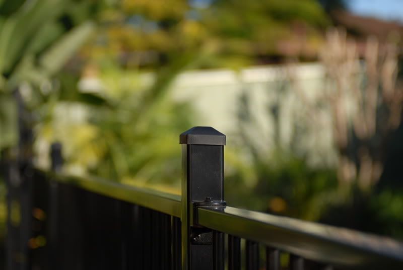

Aperture. Camera to subject, and subject to background create depth of field. Given a same aperture, and same sized subject, the longer the lens, the further the camera to subject distance becomes. Have a look at these all shot at f/2.8:
28mm
50mm
200mm
