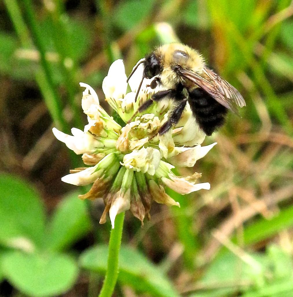

I have a Canon PowerShot G10, which does not have great performance at higher ISOs. But I took two shots - the first at ISO 400 and the second at ISO 800 - and the second one had considerably less noise than the first, even though it was at twice the ISO. I've posted the images below:
ISO 400
30.5mm
f/4.5
1/200 shutter speed
Macro zoom
ISO 800
30.5mm
f/4.5
1/1,250 shutter speed
Both taken on a PowerShot G10 handheld (no tripod).
Notice that the first picture has more noise than the second, even though it is at a lower ISO. Is this because I was zoomed up close, and so that magnified all of the noise?
This got me thinking: what are the factors that create more noise in an image? I know higher ISOs always lead to more noise, but based on these two images, it looks like ISO is not the only factor that causes image noise (because here, the higher ISO shot is less noisy). If I have to use a high ISO when shooting, are there ideal conditions I should shoot in that would reduce the noise in the image?
Thanks!

I think Overread has identified the problem in this case. The metadata reports a digital zoom factor of >1.7 for the noisier image and 1 for the cleaner shot. I take it "1" indicates no digital zoom engaged, or if not then less than the other picture anyway. Perhaps somebody will put me right if my reading of the factor is incorrect; it's a "feature" for which I've never had any use. You might want to check zoom options as your camera could be set to use digital zoom automatically upon reaching the maximum optical focal length.

Thanks for the input everybody. It seems that the main issue here was my use of the digital zoom. My camera does have a digital zoom that sets in automatically when the lens has reached its maximum length.
Could you explain to me what metadata report you are referring to? I am not familiar with this feature. To figure out what settings the photo was taken on, I just looked at the "info" bar in iPhoto, but I don't know any way other than that to find out the settings a picture was taken on.

Digital zoom is like cropping a larger picture. It does not take the picture and simply blow it up, resulting in the same resolution of a smaller section of your view. It reduces the amount of sensor being used, which causes two immediate effects. You amplify whatever's wrong with the section of the picture you're using, and you reduce the total resolution. Had you shot the first picture without digital zoom, then cropped it to that same size becaue the subject wasn't large enough, you would have had the same effect.
