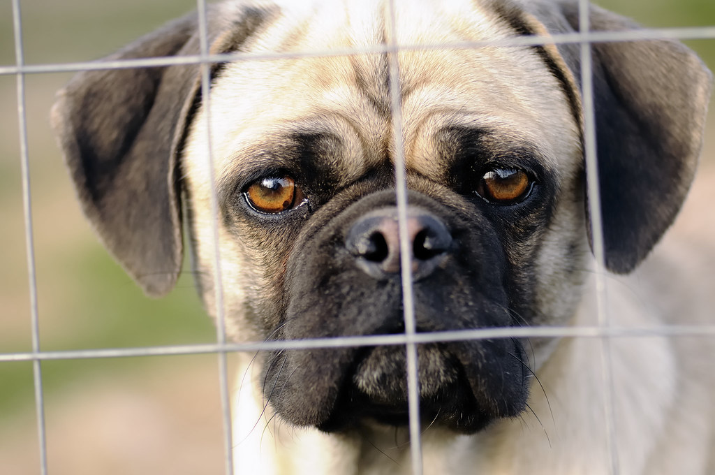

Heres a couple recent candid portraits with the tokina....

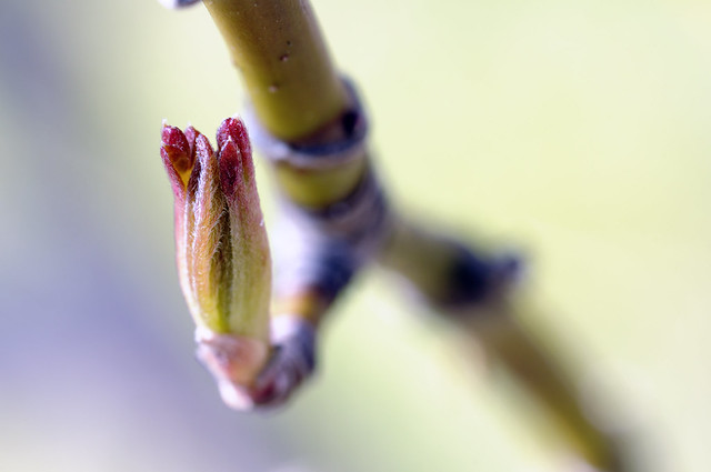

and one macro
