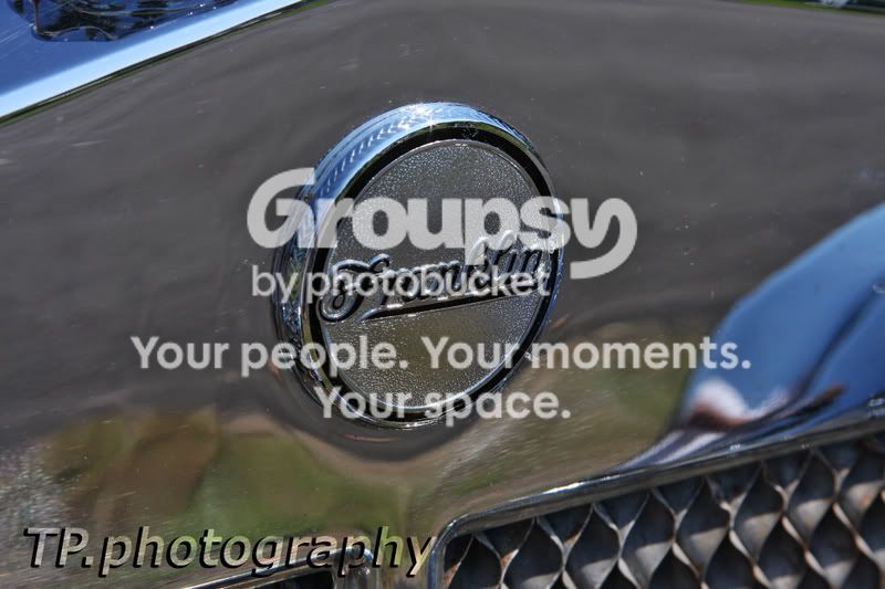

This is sort of a combo thread, a little C&C but I also have a question. I have heard that polarizers cut down on reflections and I find that a lot of my shots are ruined either from my reflection or other reflection in paint or chrome and such. Would a polarizer be the best option for reducing these types of reflections? Thanks
Green grass made the chrome green
You can see grass and dirt in the chrome on the grill

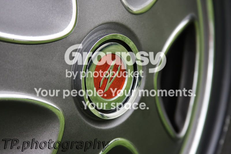

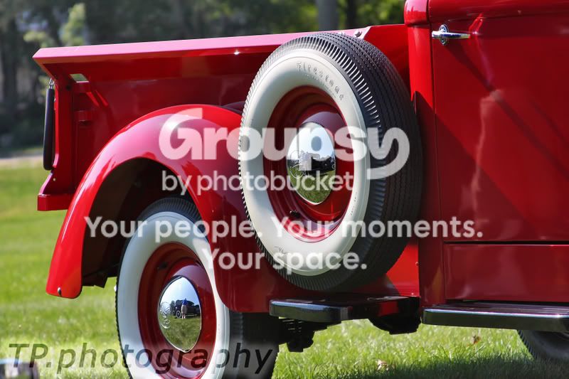

Theses types of hubcabs are some of my favorites but they really pick up reflections
Thanks again!
I'm no expert, but I don't think a CP will due everything you have in mind in these situations. The green cast from the grass will still be there. What should be cut down, but not removed, is the real bright reflections, like the bright spot on the top of the metal on top of the tire (loosing my mind trying to remember what that part is called...) The reflections that have you in them will still be there too....
I think the best way might be to get the trucks parked on pavement so the reflections look fairly neutral, and watch where you are in the reflections to try and minimize.

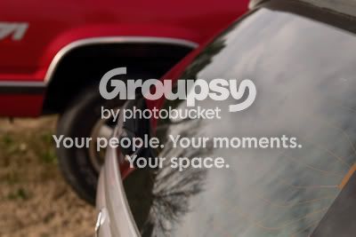

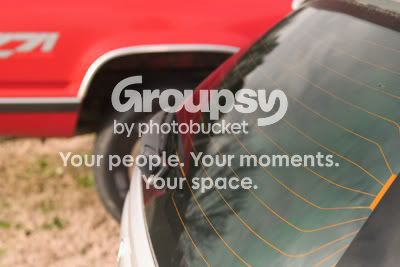

They're not miracle workers, but they do a nice job. Notice the effect on the glass.
Filter on, but not turned..................................................................Filter turned
Both are at f/4, but my shutter speed shanged from 1/500s to 1/200s to retain a correct exposure when metered on the glass.
I didn't think to get one without the filter for more obvious comparison.
ah, ok so it will cut glare but not so much reflections. Kundalini's example makes me think that although they don't cut reflections, it will put more emphasis on details in the paint (like the defroster lines on the window) and cause the reflections to be less distracting. Does this make sense?
