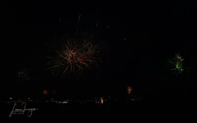

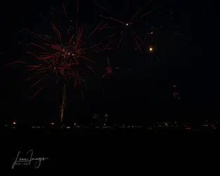

It's that time of year here in the USA. Time to break out the tripod and find a location and capture all the fireworks. I am lucky enough to live in a town where individuals are able to shoot them off for about a week. So I get plenty of practice. Well yesterday as I was hearing a few, I got to thinking of trying a new technique. About 6 months ago, I got a set of ND filters with holder and a CPL. So why not use them to make longer exposures and get multiple fireworks going off in one shot. (Note: I typically combine 3-6 images with the screen blend mode to get the same thing.)
Well here is three images that I took as a test last night. There weren't many people shooting them off at the park but it allowed me to test. Camera, lens and settings: Canon 1Dx, Sigma 24-70mm f/2.8 Art, Blue Frog Filters (CPL and 6-stop ND), f/4.0, ISO 100, shutter 2:00 minutes.
They are a little dark but I can fix that with exposure and I may have darken them too much in post.
IMHO they are a little on the dark side but other than that they look great. I really like the fine detail in the bursts. Brighten them up and repost if you would, I'd like to see them again.

They are a bit dark, yes. Trying to get the right exposure and combination of filters. I may have to go to something like 3:00 exposure on it. First thing I'm going to try tonight is to use just the 6-Stop ND without the CPL to see what difference, if any, that makes.
