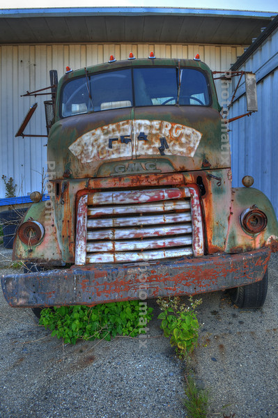

First HDR attempt:
fiveoboy01
Dec 28, 2008
684
Waunakee, WI
I tried not to overdo it, I'm not a fan of way-overdone images.

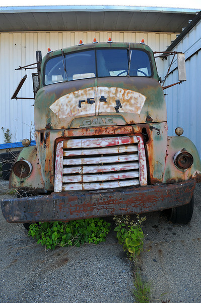

This was a 5-exposure image... I've posted the "middle" exposed image followed by the results after running it through Photomatix. Sorry for the watermarks, I plan on buying the program next week.
I think that this was a decent candidate for HDR, mainly I can see that it brought out the tread detail on the driver's side tire and the headlight buckets, as well as some detail on the sheetmetal of the buildings behind it.
But, I want to ask you guys, do you think this photo was a good candidate for an HDR image? Why or why not? And do you think I went a little overboard on the saturation?

1. I don't think this was a great candidate for HDR because there was VERY little difference between your middle-exposure shot and what you got in HDR. In fact the very first question that popped into my head when I saw the scene was "Ok, why is he making this into an HDR, exactly?"
The trick here is that there isn't a lot in a very extreme level of shadow or brightness that you cannot capture using a single exposure. Sure, there's a LITTLE, but VERY VERY little in this case.
...you actually just reminded me of someplace where HDRs would be very cool... which would be if you took a picture of the INSIDE of the cab of this beastie. Old junkers are very neat inside, but it's REALLY hard to get a good picture of the interior because of the variance of light, and simply popping up a flash totally ruins the effect.
2. You did "fine" with the treatment, I think, but the saturation is abit much and I don't think you could ever get this one really tack-on because I think you started with an off subject to begin with.
