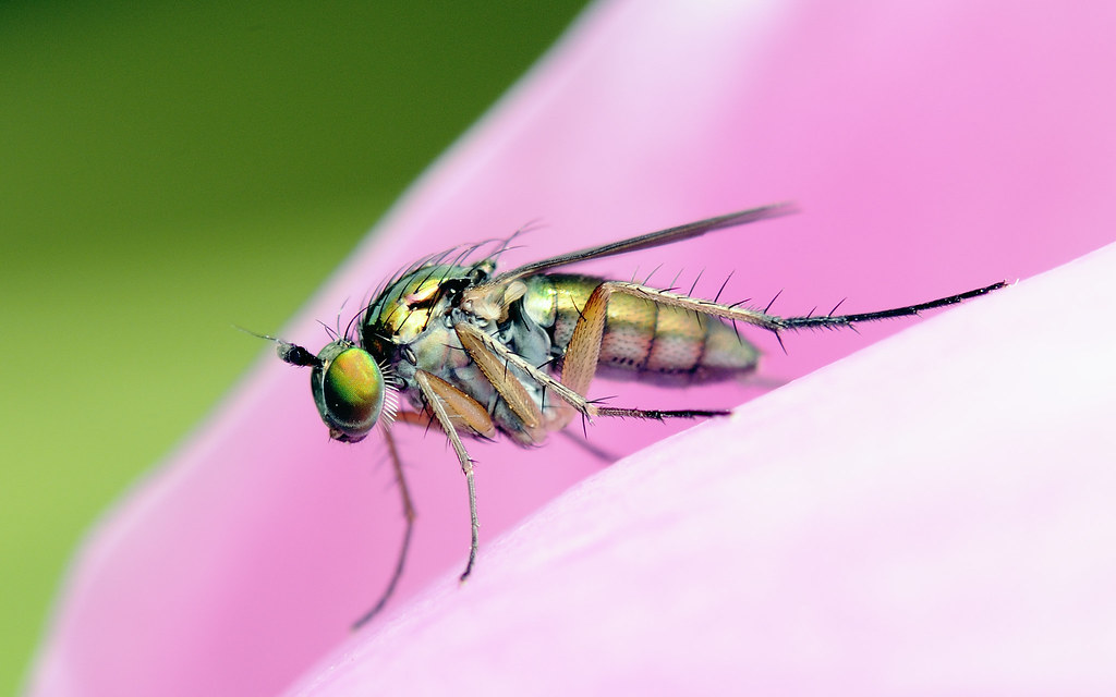

I would say a flash, in general, is a great investment in many areas of photography.

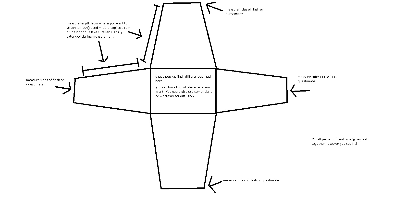

I made one of these for my sb600:
Used my 46in umbrella as a shoot through for these:

Get that Fotodiox softbox for flash that Charlie mentioned, too (or something similar)--being able to diffuse that flash will be immensely helpful. You could also DIY one, like jake showed, but the Fotodiox is so inexpensive and a great tool to have.

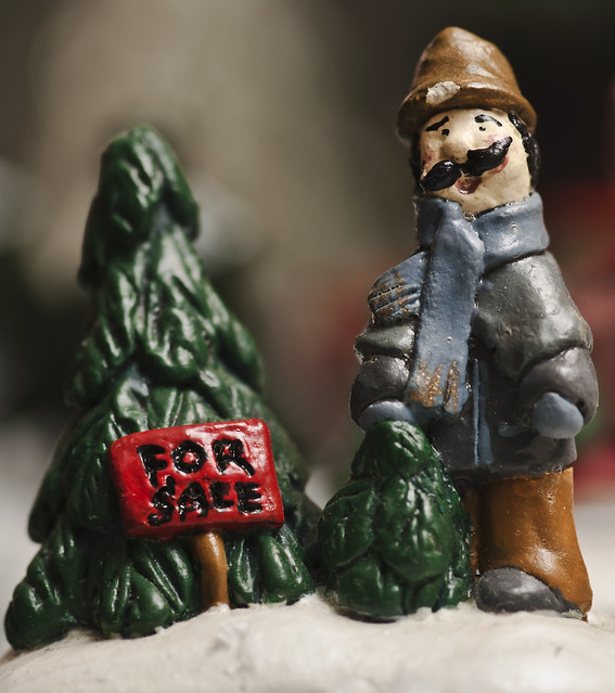

I would recommend the SB700 flash as it has TTL and can be aimed down 7-degrees which helps when using it on the camera. If you're doing on-location macro shots (ex: bugs), I would get a small softbox that can be used when the flash is on-camera just to help soften the light (you don't want that nasty flash glare on everything!). If you're doing staged shots where you can setup, I would recommend getting a TTL-cable (Zeikos sells them at a good price) and a softbox (16"x16" min but I would actually go with a 43" umbrella softbox) with stand, mount and a reflector.
Single light, 43" Umbrella/Softbox on the left and a white tray used as a reflector on the right:
Softbox and Umbrella (2 SB-600's via CLS)
Single-flash, SB-600
SB-600 on camera
SB-600 on camera
On-location, SB-600 flash via CLS

Yeah a soft box is definitely on my wanted list. I checked the one Charlie mentioned but it would have to be shipped from the states (im in the UK) so its gonna take a week or two i would have thought, and i have blown the budget and then some on the flash (cost me the best part of £300 with the TTL lead) so ill go down Jakes DIY route instead for the time being!!

WOW! the colours are amazing in your shots! They have certainly inspired me to get out there once my lens comes, especially the one of the lens. Hadn't really thought of doing much still life tbh but im quite taken with that shot, Awesome work!
Out of interest, what camera and lens do you use?? Also i was wondering if you use a flash bracket when you say on camera, or is it in the hot shoe?? The reason i ask is i came across a thread on a different forum(i forget which one sorry) where people were posting pics of their macro setups and 90% were using rather elaborate brackets. I just wondered if it was possible to achieve results like you have in the hot shoe as yours are certainly up there with, if not, the best pics ive seen in my research!
