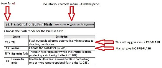

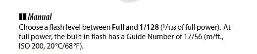

Found it thanks so much. Yes it was TTL. I have changed it to Manual. I have even worked out the output controls for the built in flash so that I can use it to fire but the output is low enough to now NOT over expose the shot and is more controllable.....Thanks It's only 1am here...and I should have gone to bed...!! But I wanted to get this into my head before I slept, so thanks for being here.
Now to go play with my new found friend the SLAVE FLASH... :)
SUNR15E
ps This might be why I had not seen it. They don't really explain that this section is the bit which turns the pre-flash OFF.
So for future reference.
I know I may have found this on my own...but with your help it has been 100x faster. Again Thanks.
