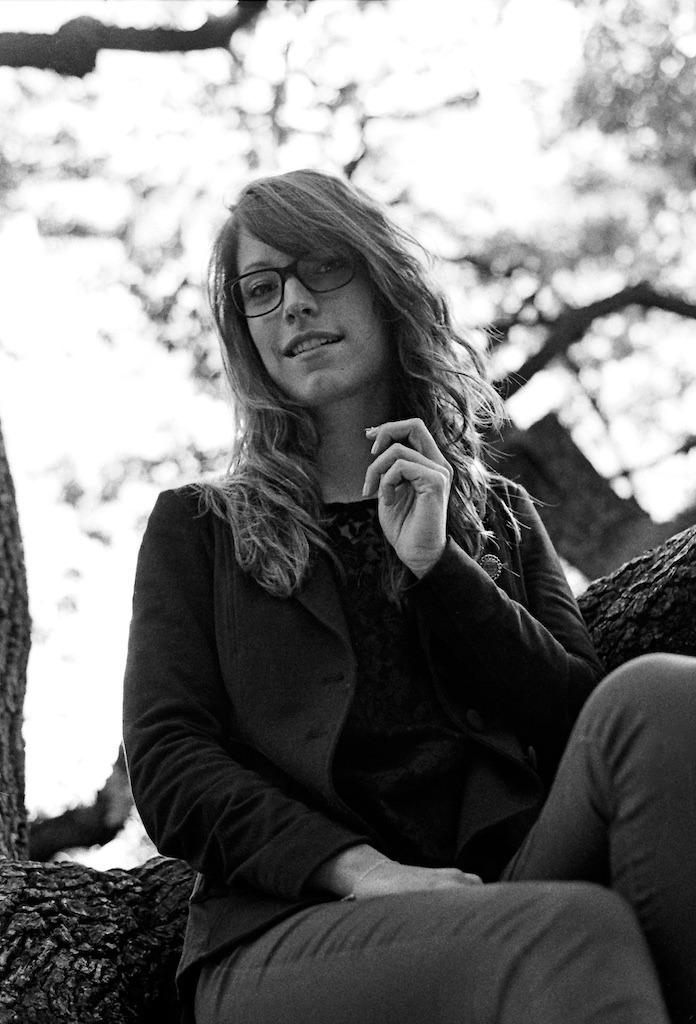

Hello everybody,
Here is my last portrait.
F90X /Tri-X & Rodinal
Beautiful portrait
Portrait is nice. But I gonna be a bit rough on you.
Why against the light. Especially with automatic exposure.
Why TriX.
Why TriX in Rodinal ? :boggled:
You placed her face in the shadow and probably didn't compensate for it. Her skin should be in zone 6-7, but now is in zone 3. Or she has such a dark skin ?
TriX in medium or large format is OK for portraits, but hardly in small format. Why ? Look at her face. This is not a skin of young woman. Unless she is 80, but looks so good.:1247: Now, Rodinal only added to the roughness of the grain as this developer cannot unlock the best properties of modern TriX (now called TX as this emulsion has just a little to do with old TriX). Why don't you use Tmax 100 for such a portraits ? In proper light it will give you a smooth gradation and very little grain if you will use Rodinal (But sensibly, no 1 hour stand, portraits do not need replated silver.)
i agree with your review.
1.Why against the light. Especially with automatic exposure.
In order to archive this look.
2.Why TriX.
Love the look of the Tri-X, the grain & the contrast.
3.Why TriX in Rodinal
Here the dilution was 1+50 with moderate agitation. In order to reduce the grain and increase the acutance/sharpness. i use rodinal this time because one of my favorite photographe use it and i want to give a try. micmojo : here is no why
Tmax 100 : i live in Belgium, it isn't a joke , we don't have enough light in cloudy day to use such slow films.
If a want very little grain or no grain, i used my DSLR.
Which developer can unlock the best properties of modern TriX ?
Thanks for your helpful review, it help my to progress.
TMX is only two stops slower than TX. Which in portrait photography might be also an advantage. :beguiled: Hm, I am in Toronto, and believe me, I didn't see the sun for two weeks now and so will be on for the next few months. Yet my base film is only ISO 250 and often I shoot at 160. For most static subjects ISO 100 will be sufficient in most situations. Just try it.
Most modern emulsions will respond well to less aggressive developers, using lower pH. The other factor would be less silver solving action. Structure of grains of silver halides in emulsions became more "sophisticated" and (modern TX is not the same film Ansel Adams knew) there is virtually no need to use ultrafine developers. I have better results using Dektol than D76 with TX. The whole idea is to not to over develop. That will preserve the delicate tonal separation and apparent sharpness at the same time by keeping the silver grains only at minimum size and nice shape. This will eliminate the need for solving silver action, which, in case of D76, will leave the grains of silver sponge like and with jagged edges which works against good tonal separation and acutance.
Rodinal has too high pH for TX causing non proportional development of grain. Again it works against tonal separation by increasing local contrast and build uneven grain. But higher pH of Rodinal will work well with Tmax 100.
D76 has way too much sodium sulfite which will dissolve a lot of silver from already formed image. With known effect.
The whole thing requires a bit of conscious experimentation to have a fun with it, but then, "fun" has very elusive meaning.
Most modern emulsions will respond well to less aggressive developers, using lower pH. The other factor would be less silver solving action. Structure of grains of silver halides in emulsions became more "sophisticated" and (modern TX is not the same film Ansel Adams new) there is virtually no need to use ultrafine developers. I have better results using Dektol than D76 with TX. The whole idea is to not to over develop. That will preserve the delicate tonal separation and apparent sharpness at the same time by keeping the silver grains only at minimum size and nice shape. This will eliminate the need for solving silver action, which, in case of D76, will leave the grains of silver sponge like and with jagged edges which works against good tonal separation and acutance.

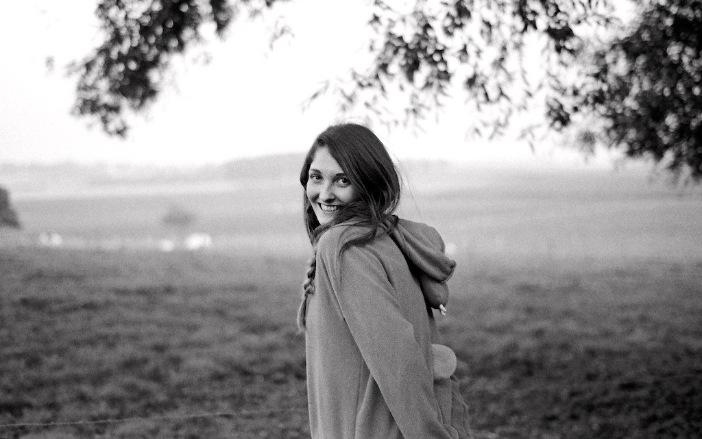

Tri-X 400 at 320 iso with rodinal 1+50.
Well, since no else mentioned it, let me. ;) That gawdawful piece of tree trunk on the left side. CROP IT! ;)
...oh yeah and that big one up in the left corner has to head for the fireplace as well.
