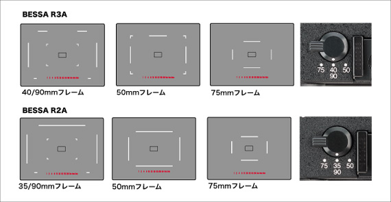

You deduce correctly. On my Voigtlander Bessa R2a (a modern rangefinder for people who can't afford Leica or the new Zeiss Ikon) there is a switch on the top for 75mm, 35/90mm and 50mm lenses. This puts different sets of brightlines in the viewfinder, the 35/90 position having both sets in there. You can't focus accurately with a rangefinder much over 90mm and at wider than 35mm you can either get a separate viewfinder that goes in the flash hotshoe, or you don't bother at all - Voigtlander make some nice wide angle lenses with focal lengths of 21mm and less where you really don't need one.
http://www.cameraquest.com/voigtr2ar3a.htm
