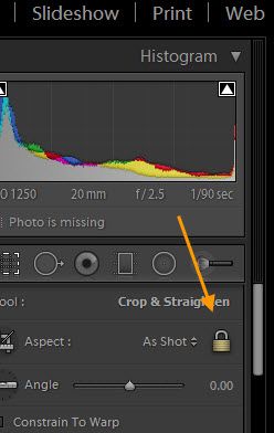

First - note crop lock that appears with crop tool.
croplock.jpg~original
