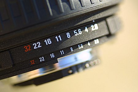

hello - my first post and i'm looking for help with a technical problem.
the top display on my camera (fujifilm s2 pro) is flashing FE E
i've changed the lense and the batteries are fine. anyone got any ideas? the camera is not responding to anything i've tried. worked fine yesterday.
You need to set the aperture ring on your lens to its most narrow - usually something like F22 or F32. You also need to lock it in place with the switch on the ring.
