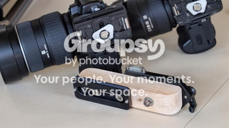

I've been enjoying using a gimbal head vs a ball head so much I thought I would cobble together a mounting plate to use non collared lens on the gimbal mount.
Normally a gimbal is used for long lenses with collars, you attach a plate to the collar and it fits into a clamp on the gimbal arm.
The plates mounted directly on the camera with a non collared lens won't work.
The beauty of a gimbal is the camera/lens is perfectly balanced on an arm that can swing in an arc vertically and turn horizontally, all with the touch of one finger...

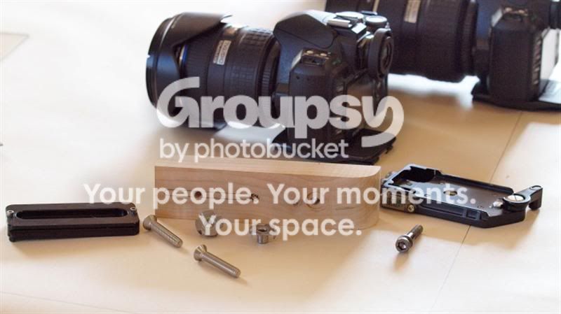

I had a spare collar plate and the quick release mount and plates from my Velbon ball head to start with. I balanced my short lenses on a piece of dowel to determin I needed a length of six inches.
Pic's are easier...
The wood adapter and hardware...

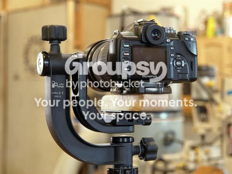

Assembled...
In use...

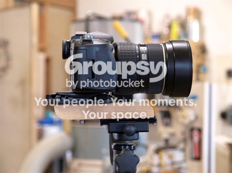

Side view..
