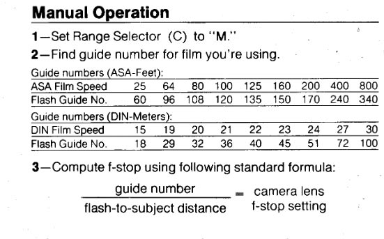

The point of the GN = distance x fstop is to easily tell you the correct distance for f/8 is GN 120 / f8 = 15 feet. f/1 has nothing to do with it. :)
Here is the Vivitar 283 Guide Number chart. It does not mention f/1

Great then, the goal is knowing how it actually works. :)
