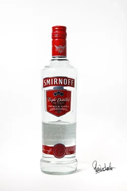

Hi forum,
I need to take some photos of glass objects, did a test to see if I am able to pull this off.
It needs to be on a light (white) background and I don't have an professional studio and lights.
In this case I used one off camera flash and just white A4 paper to reflect the light.
Tips are more then welcome
Rain
Well I'm no expert but I can't see anything obviously wrong with this one. Especially for not having a professional studio it came out pretty professional looking!
This shot looks great. It doesn't seem like you need to change anything up in my opinion.
I think the bottle gets lost in the background, specially the sides. Try to seperate it some.
I recently did something similar. But I have a studio strobe and I used a softbox on it camera top. This helped with separating out the glass from the background. You could probably use a similar setup with your speed light.

For the above photo I used only one light. Softbox was probably the key here, it was very close and at the lowest power to achieve shortest flash duration possible. You can find some light modifiers for your speed light including softboxes. Good luck.
The 2nd shot is much better. Good work!
Go to the craft store. Pick up a couple of black foam-core boards. Place them on the left and right sides of the bottle OUT of the frame (the foam-core boards won't be in the photo). What they'll do is create a reflection on the edges of the glass that will help define the bottle so that it doesn't wash out agains the background. You'll need to play with the placement of the cards to get the level of edge definition that you want.
While you're at the craft store picking up black foam-core board, pick up some white boards as well. Anytime you photograph reflective objects it sometimes helps to have a choice of of reflective surfaces that you can hide just outside the frame.

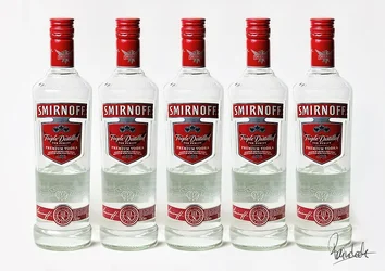

Okay an other try,
Don't see see much difference tried to add some black boards on each side but maybe they where to far from the object.
Also the background needs to be white any way I'll keep on trying :)
Grtx Rain

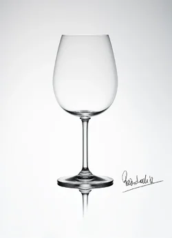

Hi again,
Last try before I get some good material like a table extra lights and stands for the black boards.
But here my last result, I'm getting there thanks to TC!
Have to tweak the light but I understand how it works now :)
Grtx Rain...
