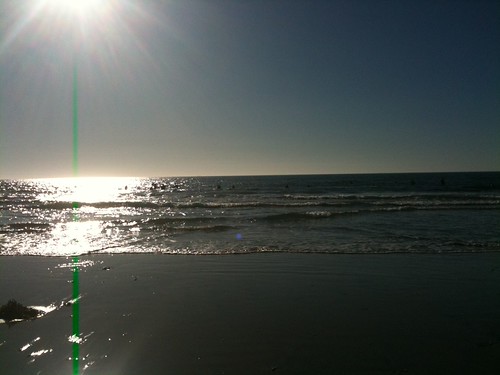

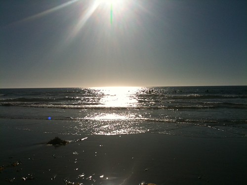

Both Photos were taken with my iPhone 3Gs, so I suppose ya'all might say that was the problem right there.. but I'm curious what caused this green line..
Taken in San Diego walking along the beach... Huge green spike emanating down from sun.. Is this similar to the "green flash" I've head so much about at sunset?
something to do with the electromagnetic spectrum?
something to do with charged coupled devices in my iPhone?
just a spec of something b/n the sun and my camera lens?

the last comment about the sensor when there's a strong light source seems the closest to a serious response.. I'd say the sun is a pretty strong light source!
I really was curious about the phenomenon and if anybody has seen this.. I assure you there was no cellophane string..
note the green is MUCH more pronounced in one shot than in the other, though it emanates from the same place in the sun..

It is a flaw in at the edge of the sensor when you have a bright point light at the short side of the sensor. It is caused by that light getting under the black border that rims the sensor.
I think it has something to do with the offset microlenses and that the black border is not actually on the microlenses allowing light to get between the border & microlneses and shine into the sensor that is supposed to be dark/black.
Just move the point light either completely into the frame or well out of it.
