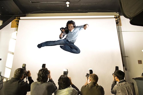

The thing with green blue or white backgrounds is that you must take into consideration colour casts. If your white subject is on a green screen, if you do not do it right, you will get green fringing on your subject and then you are in trouble. Using the same colour background as what your final shot will use is the easier and more complete solution.
For example... had I used a subject jumping from a green screen, the result would not have been as good so we used a white background in this case.
