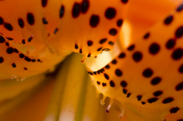

I shoot my macros handheld probably over 90% of the time. I use a flash with a DIY diffuser. Hoping to get a flash bracket soon to give me a little more control over the direction of the flash, but still, I think the results are pretty decent.
daylily_1369 by sm4him, on Flickr
You can see some other examples on my flickr page, using the link under the second photo.
