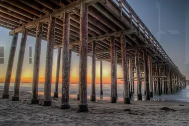

Well at the time of post, I did not render any photos that gave me the problem. Here is one that I did that shows my issue. the shadows under the pier are very heavy and the sunrise is very bright. Maybe combine that with the moving water. But for sure, I have no clue what I am doing with Photomatix, thus, posting here for help. check out my image and see if you have had this happen. The problem areas are in the sky, top/right and sky between pilings, lower/left. Thanks in advance!

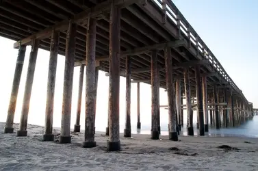

Here are the 5 images I used. I shoot in RAW (NEF files), import from camera to Lightroom 3, import from lightroom 3 to Photomatix for editing and merging, then back to lightroom 3. Most of the images I have processed turned out great.
Try building the HDR by taking one image out of the stack and see what happens. Take a different image out of each attempt. Maybe it's just one image the software is having problems with.

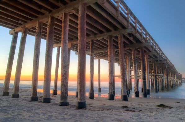

Those images are pretty small but it worked fine for me. Must be something on your end. Have you updated Photomatix yet?

That issue has nothing to do with the pylons, and those artifacts don't seem to be on any of the single images. There's something goofy going on in the processing...
Looks to me like there is an image in the stack that doesn't belong in the group. I see windows on the left. I would recheck the files that you are selecting.
Why are they windows? Yeah, they're rectangles. But that doesn't make them windows. Unless you're seeing something the rest of us are missing.
Ok, the rectangles LOOK like windows. Regardless of what they are, they don't belong in the image and I am convinced that they are the result of an image being included in the stack that should not have been. Give it a shot. Stack three images to import into your favorite HDR app, and add another that doesn't belong. You will see the same type of artifacts in the the resulting image.
I don't think its an image in the stack that doesn't belong. IT did not do that to me when I processed them. It could be a bug in photomatix though on his computer.
OP try uninstalling the the software and reinstalling.Maybe that will help.
